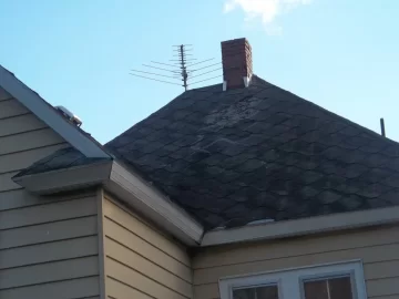

Here is what part of the roof looks like from last april. It is in much worse space now. To the left of the photo is the long run of about 45 feet.

I agree. Do not go over the old shingles . Make sure there is a minimum of 6' of ice&water shield from the drip edge up and at least 1 roll rolled down the valley. This is a bare minimum in this northern climate. imho
Well, that is a tough one for sure. Price probably isn't that bad.
