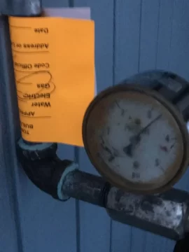

Hello

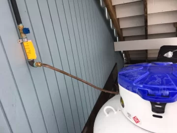

After almost 2 years of a non-working fire place, the gas line was extended today! It is now under the 4 PSI test waiting for inspection. See pic
Tank was under the deck and now is in back of the new workshop under the deck stairs.
Is it a good idea to have a shutoff on the line near the tank?
  • [Hearth.com] LP gas line extension Is outside shutoff a good idea?
It's ok to have one there. If that's the only gas line coming off the tank, it's not needed, since you can shut the main off on top of the tank.
If there are other lines feeding gas elsewhere in the house, it's nice to be able to keep gas flowing...

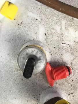

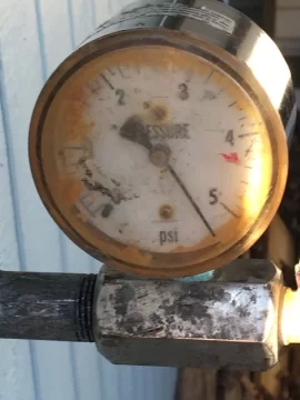

I just noticed the PSI test jumped up to 5.5 PSI after the temp went Down To 16 Deg F!
I thought the cold would decrease the PSI like in my car tires??? Does that make sense??
Thanks
I am assuming the test is a nitrogen test. Nitrogen does respond to temperature but less so than most gases. It could see a slight DECREASE in pressure with lower temperature. Does the extended line run through the house? If so has the temperature risen there.
Even if it isn't code imo there should be shutoffs within reach of all appliances being served.
Here is a calculator for changes in pressure due to temperature for nitrogen
http://www.oceanhvac.com/nitro.php

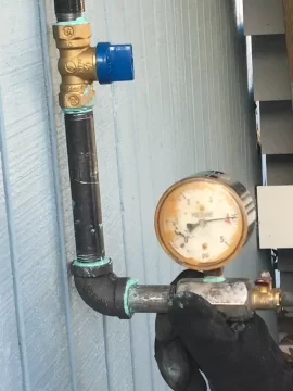

Hello
The standard test isb nitrogen so you must be right. I called the gas piper and one of his guys came out and lowered the pressure back down to 4 PSI and the next day it went down to 3.5 PSI.
Anyway the inspector came and passed it.
Now the gas company can connect the tank.

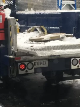

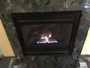

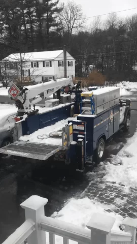

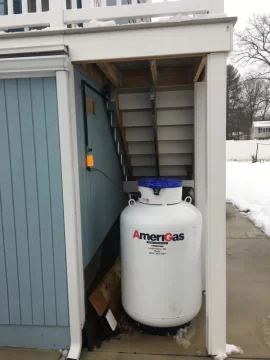

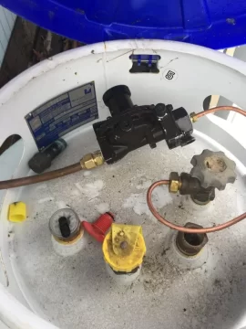

Finally after 2 years of building the workshop under the deck and moving the tank from under the deck to behind the new workshop under the stairs going up to the deck, we are heating with LP gas!
Do not need the cement biscuit in the truck anymore that was under the tank when it was under the deck
We poured a little cement under the stairs and a walkway to the tank for easy access. :-)
See pics
