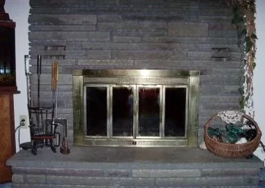

Hi folks! I've been lurking and doing some searches but I need your help. I "pulled the trigger" and laid out a down payment for a Hearthstone Clydesdale insert.
Single level ranch house with a straight shot from the fireplace through the living room, dining room, and kitchen( approx.60' X 16' total ) with hopes of expanding the heat range using fans
into adjoining rooms. My question is regarding install....I have measured inside a million times and I'm sure she will fit(not the flush mount) but it's tight...
How much minimum interior clearance, if any, is necessary??
Here's the fireplace she's going into( I hope!)......

I just measured again. Based on the catalog diagram it appears that at a depth of 13 and 5/16 inches I need a width of 31 and 1/16 inches.
It is very, very close so:
Is it OK if the insert touches the interior sidewalls of the existing fireplace?
If there is a gap between the surround and the stone face of the fireplace(there will be anyway because the stone is not flat like brick)
what would you recommend?
Thank you.
my setup is almost exactly like yours. One option is to ask for a larger surround. My stove had a larger surround, that I purchased, to take up that half of inch around the insert. They would of put it in, with the smaller surround, but said that it would just look funny with the gap. I thought of ways to put a medal place painted the same color around it, before the stove went in to take up the slack but it was not needed. The surrounds do have some insulation that you can pack behind them, to make it more airtight. I have heatilator holes above my insert, in the rock, so mine is not airtight, so they said don't bother, some of the heat will just radiate out the holes, which is fine. When they were measuring, it was purely just making sure it would fit, including the slant in the back of the firebox. I am not an expert, by far, but I asked a ton (I know some people are nodding their heads right now and rolling their eyes :) ) but I think as long as you can get it in the hole all the way, it is fine. It pulls air from the room. Yes the insert box gets hot, but so would a fire, in that fireplace. Someone will correct me if I am mistaken. My rock is not flat either, so unless you were to put insulation in the surround, lots of places it is not airtight, around the outside of the insert, in my situation.

Yes, thats fine. Hope it fits without having to force it too much.
If the gap isn't real noticeable, leave it be.
Prolly best to leave it as is. Larger surround is the ticket for the gaps from stone side to insert side. Once you cover that up, any gaps behind prolly won't be that visible.
