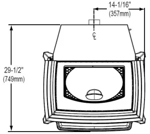

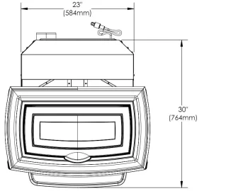

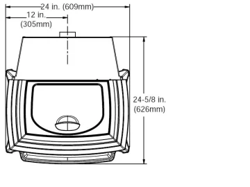

Isn't the vent offset from the center of the stove too? It looks like the non-AE is centered like my Castile. Since you have a corner install (like me) isn't that as much of a problem as the height, assuming you want to keep the stove centered in the corner? I know I was thinking about it if I ever upgrade my Castile to a Mt. Vernon AE. That alone made me feel that I made a good choice going straight out like you did because going up then out wouldn't have helped with the vent offset from center. I accepted the fact I would need a new vent/thimble location.
If I recall correctly the M55 is offset also, but to the opposite side!

This is what I was talking about. Look at the vent locations. It's a problem for corner installs like we have.
