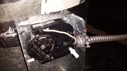

Hello all. Just getting started with the pellet stove scene. Had a power outage the other day and ran my stove on a generator which I dont know if it has anything to do with the issue I am having now. I ordered a new plenum fan limit switch (200off 140on 90off) as I thought this was my issue and as soon as the stove cools to 90ish the switch will click but fan will run non-stop until about five or so minutes after I shut it down. Am I looking at a snap disc issue possibly? Hope I got all the info you guys need!
Lemme know if you need more.
Appreciate the helpin advance!!
NICK

But when it drops to 90° You can see the switch and also hear it click thus meaning the stove should heat back up to 140 and distribute that hotter heat. My old plenum switch worked before we had a power outage now my convection fan just runs non stop 24/7.
I know on the 3500 the fan circuit is hot and the snap disk controls the fan.

Emailed them. Didn't get very far. Is this switch wired correctly?
