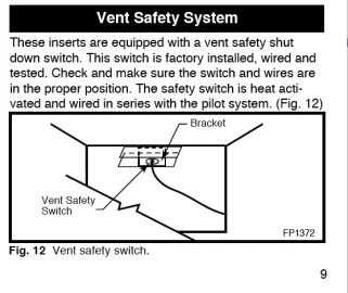

IIRC, that safety mechanism was on the lower left side of the unit,
located outside the firebox...Been awhile since I worked on one,
but that's what I remember...
