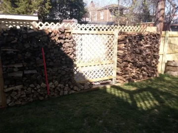

Here is what we use and I have 5 that are 4 wide x 5 1/2 tall and 16 long- 1 that is 20 long - 1 that is 8 long and 2 that are 4x4x 5 1/2. I got them on the south side of my property
I like the look of this one, but the pic doesn't show the back side. Is there anything along the back of that? I was thinking that something like this with maybe some type of lattice attached to the back side might be nice for the public facing side, especially since it would still look a little like a fence when there is no wood there (can't keep the whole thing stocked full of wood all the time, right?).

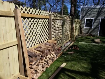

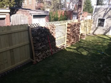

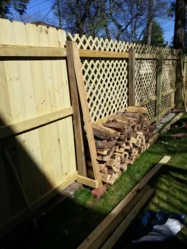

Yeah, so basically just a permanent rack. Span the 8' with some lawn timbers or something. I like the idea of lattice on the back side. The posts would blend with the rest of the fence. Although I guess at this point I basically have wood stacked against a fence without pickets. We'll see if I can sell it to the Mrs...
