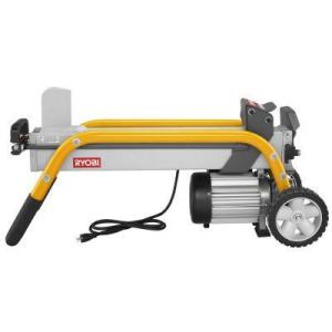

since i got a new splitter i now use this to make kinding - works just fine
[Hearth.com] Making kindling
The neatest and easy way to make kindling is with a log splitter!
I burn a fair amount of soft maple, so as I am splitting, when I come across a nice looking piece, I simply split it into about 1" square pieces with the splitter. It is amazingly fast doing it this way and the only thing you have to be careful about is, depending upon the wood you are splitting, some could snap off and want to go flying. I've had that happen a few times but only a little sting.
My method is to sit while splitting wood (a necessary thing with my body). Using an old milk crate with a hot seat on top, I just put my left hand on the log and right hand on the lever. It takes very little movement of the wedge to make the split. Raise the wedge to just over the log and bring it back down again.
