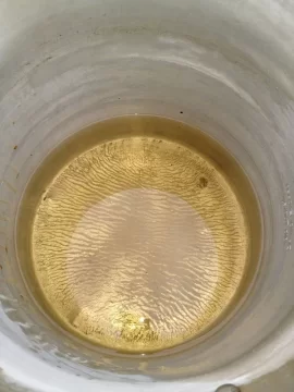

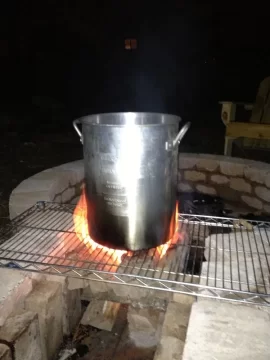

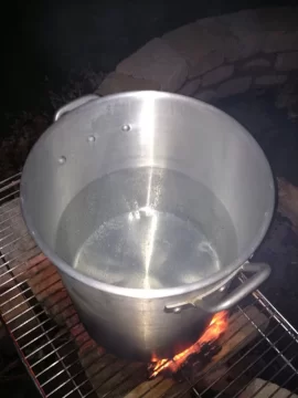

So like an idiot I decided to start boiling down my sap last night at 10 pm. Don't ask. Boiled down like 6-7 gallons in a turkey fryer pot. Couldn't stay up into the night and woke up to the picture below. It's probably something like a Gallon of yellowish sap with alot of "sugar sand" as Scotty calls it at the bottom.
Question 1: Do I boil this down more outside before brining in to finish?
Assumption 1: This sap needs to be filtered before bringing to finish.
I realized "cheesecloth" and my coffee filter aren't good at filtering Sap. Guess I need to hit up amazon.
Question 2: Should I be maintaining a certain temp while I'm boiling outside (wow, hope that doesn't sound stupid)?
Question 3: Do you recommend filtering the "yellow sap" and storing it a week refrigerated before finishing?
Any advice is helpful.

Stax, I use wine maker filter bags. You can get them really fine, too. I'm pretty sure my bags are half micron, and you want to filter the syrup when its warm (not blazing hot, but warm). You'll be better off storing it in a gallon container in the fridge until you get a chance to finish it with more sap, etc. Or you could just finish that batch off, then let the sand settle on its own. You should end up with close to a quart of syrup if you boiled 9 gallons of sap.....
Keep in mind, most maple syrup makers "rack" (put the syrup up for a period of time) to make all the sediment fall to the bottom....
The sediment is harmless to you, but it is unsightly to see it in the syrup. I skim my syrup through a filter bag right out of the evaporator when it's hot (pretty sure it's .5 micron, but I can't remember. I do know it's super fine).
I then let my syrup rack for a week when it's close (it's probably around 55 to 60% sugar), carefully pouring it out of the racking bucket so as to not disturb the sediment at the bottom of the bucket....then I finish it off on the kitchen stove and bottle it.
I would get rid of the bulk of the water outside and then bring it in to fine tune/finish. Check Scotty's comment, above, with regard to guaging it based on the volume of sap you started with.
No need to be too fussy. Generally time is the most important factor, so you boil as hard/fast as you can. You could simmer it and (eventually) get the same quality of syrup.
Pay very close attention as you get closer to finishing it. At first you are removing a lot of water and getting a small change in sugar content. As the process progresses, it takes much less water removed to significantly change the % sugar content.
Ummm, yes, it is OK to store it and then finish it, but no advantage to doing so.
No matter how well you filter, if you then bring it back up to a boil you will once again have sediment, or at least cloudiness. I think the magic temperature is somewhere around 190 degrees, but am not sure about that. All perfectly edible, only reason to be fussy is for asthetics. We have used dairy milk filters in the past for stovetop batches. Not ideal, but seems to work OK.
Reactions: ScotO
Temperature depends on altitude. Here in central PA the magic number is around 218 degrees......that is considered syrup.
But you don't have to be too picky. get it where it looks nice to your needs.......
It's a pretty simple process - just boil the bejeebers out of it until it gets to 7°F above the boiling point of water. Just keep adding in more sap as it boils away - it can seem to take forever if you've never done it before. It's around a 40:1 ratio, so that's a lot of boiling.
That's the 'official' boiling point of syrup - but you could likely stop before you get to that & call it good if you don't mind it a little bit thin. As mentioned, the closer it gets to that the easier it will scorch - so make sure you've got at least a good couple of inches in the pot. If you get your sap used up before you get syrup, and are left with too little to keep boiling, you could refrigerate or even freeze until you get more sap to add to it - and the less you clean things the less you'll lose to wash water. And don't ever use any soap when washing anything that it will come in contact with - hot water only. There has been lots of syrup lost to bad taste from people washing their filters using some kind of soap, or even throwing in the washing machine without soap. Also, soap isn't the only thing that will off-flavour syrup - it doesn't take much of a foreign substance to mess the taste up (turkey grease would not be good :) ).
And the only way to eliminate sediment is to use a filter press - so don't sweat it too much, just filter as good as you can with what you can get (decent suggestions above). You could try doubling up your filters, or filtering multiple times.
Reactions: ScotO

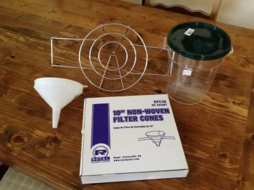

Hopefully forecast will hold up. Need the sap flow to return. Who knows, maybe it wont. Went to the restaurant store last night an I was able to pick up a couple processing supplies. Got some filters (for oil fryers) a stainless steel cone holder, a 4 quart storage bucket and a funnel for the mason jars I'm going to get. More boiling today.

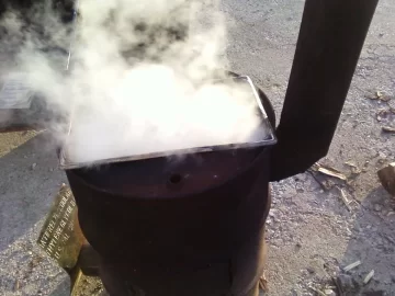

I used a turkey pot with a propane burner for the first few years. I experimented with a few different pots and cooking methods and this is the best set-up I have found so far. I use a stainless pan, it's actually a pan from a buffet. It's 5" deep 14" wide and 24" long.
I was shocked to see how much faster a shallow pan will boil down than the turkey pot would.
It's my 2nd year using it. I only make a few gallons of syrup each year, if I had more time I could definitely cook alot more with this set-up.
