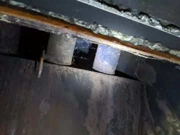

The liner in this 1950s masonry fireplace is rusting out. Where liner meets brick mantle on sides and top, insulation is exposed. The flue is rusted and immovable, and airflow is evident by the fluttering spider webs up there. A chimney cap and some kind of reinforcement was said to be done by previous owner after the quake, but there is no documentation of this. I have next to no knowledge on this topic and am eager to learn more.
My first thought is to paint the rusty liner, weatherstrip the exposed insulation, and put some kind of ceiling in the fireplace to block the draft (and spiders) from the flue. Please tell me if this is a stupid or unsafe idea, lol!! Could this create moisture issues? Is there a better solution? Advice appreciated :)
The metal chimney sounds suspicious. Is this a full masonry fireplace, a ZC fireplace with a masonry facade or a heatilator style fireplace? If full masonry it sounds like there may have been an insert installed at one point. If so the liner should have been stainless steel. Post a picture or three if it will help.

Thanks for the response. I had to look up what the various fireplace types were! Very new to this. I will post photos.
[Hearth.com] Masonry fireplace after earthquake

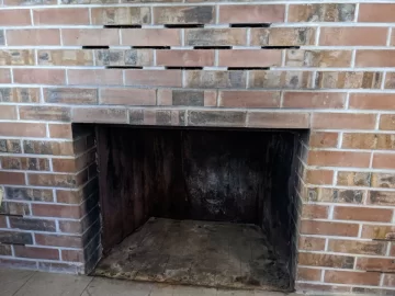

Sounds like I was wrong to call it a masonry fireplace. Seemed like a safe call because everything about this house is solid brick - it was built by a mason for his daughter.
Ok, this looks like a heatilator style fireplace. It looks like the safest approach would be to install an insulated 6" stainless steel liner and an insert if the goal is to produce safe heat.

Thank you for the insight, it gives me a starting point. That could be within my means to do, but I'm concerned that more unseen damage is at hand. Otherwise, I'm not sure why previous owner's inspection would result in calling it inoperable if it was just a matter of putting in a new liner. Until I have more disposable funds on hand to deal with whatever crops up (doesn't seem wise to be a big spender in these unusual times), I am not ready to try fixing it. Just hoping to block the draft and make it less of an eyesore for the next few months.
An insulated 6" liner would be inside of the current liner providing a protected flue from the insert up to the cap on top. You could block it off temporarily with some cardboard to reduce draft.
