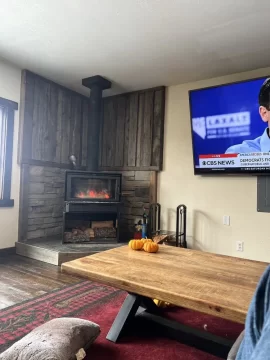

I have been running my BK Boxer wide open and still having trouble keeping my 1500SF well insulated single level house above about 64 degrees
I’m wondering if I’m sending a bunch of heat up the chimney and maybe I’d be better off turning it down just a little bit?
Any thoughts?

Brand new stove last winter but only got it about Feb so not much time driving it
The room it’s in will get to about 70ish pretty easy but my house is wide open and I have a big wall Mount fan pushing the heat towards the rest of the house
Chimney is close to 20’ tall and double wall until the roof then it’s triple wall
No probe
All gaskets are fine
Freshly split and test I’m between 14-18% and it’s 100% Doug fir which is the best wood available in my area

I have a box fan on low that pushes the air towards the wood stove room and then a big wall Mount fan up high that pushes the heat out of the wood stove room
I believe it’s triple wall above the roof because it’s silver but I may be wrong. Installer was the installer for the dealer that sells BK stoves so I hope it did it the best way
I have 8’ ceilings in the whole house.
My room that the stove is in is about 400SF living room roughly but it’s really open to the rest of the house

Proper amount of windows including 1 in each bedroom, 1 brand new 4x8 in the living room plus a small 2x2 window on the opposite wall, a French door leading to a deck in the kitchen and then 1 window in the dining room, 1 bathroom has a small window
I can get the thermostat just past the hottest point on it with it wide open and the cat engaged.

Begreen's question about whether the thermostat works as it should is on-point as well. Especially if the pic you posted was with the thermostat wide open (as I would do if the room temperatuer is 64 and I wanted it to be 70 F) - there should be flames visible (at least, there would be in my stove, with that amount of fuel left).
So, when you have flame, can you see that moving the thermostat changes the flames?
If you decrease the thermostat (right until you hear a "clang"), do the flames die down? And after a while, do they come up again?

If I close the thermostat down until it makes the noise the flames will die out but they never come back. But the whole load will burn just fine I just won’t get flames again unless I open the thermostat back up a little
When the thermostat is wide open I have flames. Not sure why they didn’t show in that pic but they were either there or I was down to coals…not sure
Sounds like thermostat is working as intended.
