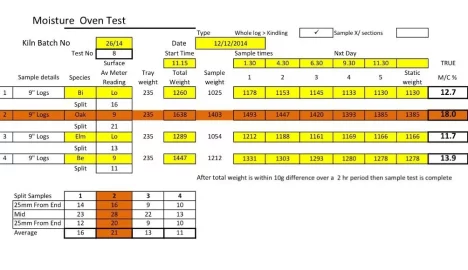

I have uploaded a copy of the oven test results he mentioned in his email. He has highlighted oak in the list becuase that was the last batch I had trouble with. My current batch is mixed hardwood in which the largest splits are not oak.
I will get in touch one more time and mention the case hardening possibility. Although I fear that, if they are a small company they may struggle to keep their logs in the kiln for longer, as Gyrfalcon has said.

Well your first guy talks a good show. Random testing whatever method so not every piece is perfect. Point is its still high in the middle. That's a problem for you. Can you talk to him about keeping the split size down for you- might be your best way out. As with everything in sales, marketing has a license to stretch things quite a bit- consumer beware.

Fiona, I am not familiar with the Jotul F3cb, but I don't know of any stove that will run OK on 28% that doesn't run better on 20%.
The other thing to consider is the "average" moisture content of a piece of wood. If you got a little tiny spot of 28% at one end that drops off quick 26-24-22-20 % going end to end and 3/4s of the total piece comes up 20% with a tiny bit of 28% at one end, sure burn it.
But if you got a 20% shell with a 28% filling it sounds case hardened to me. Just split one open to see how much of it is at 20% and how much of it is 28%. Can you find any area at all that is 22 or 24%?
