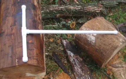

Somewhere on the net I saw a marking tool made of 1/2" PVC pipe filled with powdered chalk. It's a T with all caps on all 3 ends. Make a cut at the length you want in the top of the T so that some chalk can come out when you tap the log. I start at one end of the log and mark all the cuts, just move the uncut end of the tool to the last chalk mark and tap. It takes only a few seconds to mark a 40' trunk. I can cut round after round without stopping to measure. I like it because there is nothing on the bar to get in the way and it is CHEAP.

Sorry to take so long to post my pictures. It gets dark so early I can't get out after work to do anything.
I cut my rounds at 16" which is what is recommended for my Quad 2700i, the max is 18". Before I bought my insert, I was cutting wood for my fireplace at random lengths between 20" and 24". I had most of a cord CSS when I bought my 2700i so I needed a way to quickly trim it to size. I saw a metal version of the bucking frame somewhere, but the wood version is much more chain friendly. I loaded the left section to the top and cut 30 or 40 splits in just a few minutes. Now I load it with whatever I can lift into it, up to about 6" in diameter and 6 feet long. I load the end even with the 2x4 on the left. Anything too long gets trimmed at the right and piled on top. It makes quick work of smaller logs and branches.
The Tap and Cut is just a T fitting with 3 capped arms. The handle piece is long enough so I can mark a log on the ground without bending over. It is a great time saver and cost only a few bucks to make.
