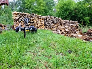

i took a 3/5 day off work yesterday and split some wood, rode my bike, and got rained on! I had 2 piles of elm that I needed to get through, 1 was stacked in the direct sun, on 4x4 w/ cinderblocks. The other stack was in the shade, directly on the ground, and covered in virginia creeper. Both were cut at the same time.
the pile in the sun was all <20% and split like a dream.
the pile in the shade was around 25% and was still pretty stringy.
I moved on to the pile of fruit wood that I still need to process (it had been stacked on a pallet, but in an effort to move it closer to the stacks, i just tossed it out of the truck. That was all <20% as well.
I tested 1 piece of maple and some pine that I randomly pulled from the stacks... Maple was 16%, pine was 18%.
The stuff I have for next year stacked by the house was coming in at 12%
This picture is not very good, as you can only see 1 pile, but there are 3 rows of pallets here. Total of 9 cord here (including the pile of elm on the right) + the 1/2 cord of fruit trees (on the left in the grass) that needs to be processed. No idea what I'm going to do with the giant pile of elm bark....
I would compost it. Some bark makes good fuel but elm bark is one of the worst because it has a very high ash content/btu (and lower btu/lb than almost all other species).
