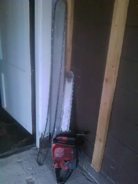

I've been going through the same analysis. I picked up the 2095 with 24 and 60 inch bars for $400. Figure that gets me into the milling game for a grand and I have a saw for the big stuff.
That's a helluva deal. The 60" bar alone is worth that much.I looked for a decent Jonsered 2095 also (lots of parts interchangeable w/Husky 395) but after a few months of searching & waiting,I gave up.Not many around I noticed on the market that people are willing to part with.Parts found occasionally but almost never see complete running saws for sale.I dont think J-red makes any saws over 60cc now,once Electrolux took over Husky also they consolidated lots of the 2 product lines.

Yeah, had a buddy pick it up for me as soon as he got out of work the day it was posted. Didn't want to miss that one. There are a lot of good deals out there if you are patient.
