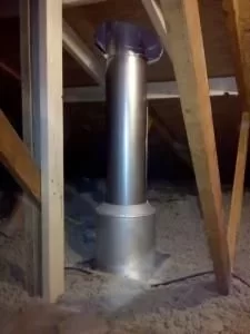

The ceiling support box just supports the chimney at the room ceiling, it doesn't need to be longer. Raw class A pipe will go up through the attic to the roof with an insulation shield around its base at the support box. It will look something like this in the attic.

Thank you for the picture and explanation. I actually like this method better. It seems I don't need the entire enclosed box with the ceiling support then like the Duravent ones I've been looking at. If I were to remove the attic insulation from around the ceiling opening, would I still need the attic insulation shield?
DuraTech / DuraVent has this exact same solution. I suspect you are looking at the wrong ceiling support boxes. By the description it sounds like you may be looking at cathedral ceiling support boxes instead of their flat ceiling support boxes. Yes, you will still need the attic insulation shield. No big deal.
