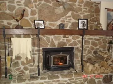

I've read quite a few posts, in almost all the categories on this site. Many of them mention using a moisture meter to verify the moisture content of the wood, looking for <15%. The bulk of our home heating is with a Buck 91, and I'm very happy with it. I process the wood mainly from standing dead or dying trees on our property, stored under a shed roof for at least a year. One particular tree processed last year was a red oak that died in the autumn of 2014. When felled, the sapwood was punky so I split it off, resulting in some very nice looking heartwood. It was under cover for the last year. I'd planned on using it during colder spells, but it is still not dry enough to do the job with daytime temps in the teens and overnight lows in the single digits. I've got plenty of other red/white oak, hickory, and hedge to ward off the chill. Most of it was left bigger. I prepped that particular tree with colder weather in mind. By stripping off the sapwood, it left nice square cornered splits that could be stuffed into the maw of the 91. This method works well and leaves little space between the individual pieces of wood, giving some bodacious overnight BTUs.
All that to ask the burning question. What brand does everyone have/use/recommend. Thanks in advance.

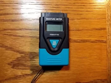

I'm still kind of new at this whole firewood thing, but I've been gathering and stacking it for a few years now while we save up to replace our open fireplace with a wood stove. Meanwhile the wood keeps drying..
I use, and am happy with the moisture meter I got from Harbor Freight a couple of years ago. It looks like this.

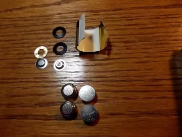

You can find similar ones on Amazon too... I like this style because when I need to replace the batteries I just buy a 2 pack of Energizer A544 camera batteries and when you peel off the tin cover, there are 4 LR44 button batteries in each one..

Thanks for the tip! I've got the same MM from HF and it works well except that the batteries don't seem to last long when it's sitting idle. It has an "auto off" rather than a hard switch and I wonder if there's a small current draw when it's supposed to be off. Either that or maybe mine got jostled enough in the drawer to turn on from time to time.

I also have the Harbor Freight one and it has always worked but today something odd happened. I took it out of the draw I keep it in and tested it across the palm of my hand like I have done a bunch of times. It read about 35% bout right according to what I always read. Then I went to a piece of wood by the stove and stuck it in and it read 0 % so I checked 6-7 more pieces and the same 0% reading in each piece? I expected the wood to be about 10- 13% or so but I know 0 % is wrong. Is this typical of low batteries? Or is she all done?
Reactions: Gboutdoors
Yeah Jeff it sounds like battery change time. Same thing happened with my lil HF one the other day.
Thanks for the response Bart,
I have a small battery tester I put each of the 4 button batteries in it one at a a time. Each one says poor condition. The unit supposedly has a battery icon that will show up when batteries are low but it does not show on the screen . But for a dollar two nighty eight what can I expect ha ha . I read at the top of the post that you can buy a camera battery and take it apart? and inside are 4 of the correct size batteries maybe I will try that?
They are a common button battery. I have a bunch in a drawer for stuff around here that I bought off of eBay.
