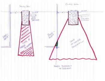

rayg said:
I ripped out my basement this summer and put in drainage to take care of the downspouts and subsoil. I designed it myself (I'm a land surveyor) and got the Civil Engineers at work to cross check me.
The attached link shows some of the progress. Solved the problem though.
http://thedocumentist.wordpress.com/2011/08/16/home-improvement-projects-you-will-want-to-remember/
Ray

It's amazing how it took care of the problem. Taking care of the downspouts and window wells eliminated entirely the surface water ingressing through the block wall of the basement. After putting the drainage system in it took a further two weeks to "dry out" the cinder block basement walls with a dehumidifier at which point I had closed cell icyene foam sprayed over the top of the cinder block. The basement, for the first time in it's 30year life span hasn't smelt like a basement.
I was fortunate though that I had some elevation grade on the property where I could dump the runoff water down hill. I think I had an 18" fall to play with and the pipe grades worked out to be 1.5%. If you were going to dump in to a dry well the first question you should try and resolve is what type of soil would the drywell go into. I considered a dry well until I did a test borehole (6' hand auger took care of it) and found out that I had clay soil. Water doesn't perculate into clay all that well, so all I would have had (if a drywell was installed) would have been a wet well, with no way for the water to drain away. That's not a good solution, especially when the "dry well" fills up with water and then fills back up the drain lines. If you have a sandy soil then a dry well works wonders and can solve drainage problems quite readily. As for the distance from the house ? The question acutally becomes how does water interact with soil and how deep will the well be. Water, when it hits a very sandy soil (lets take beach sand for this example) drains in the form of a cone below the point where water hits soil. The sandier (if that is a word) the soil the narrower the cone of wet sand, similarily, the denser the soil (that is, the smaller the grain of sand) the greater the spread of water in the cone of water penetration. This cone of penetration can be at an angle of 45° depending on the soil type (see the attached image). Ok, all that said about wetness cones to say that the distance of a "dry well" from the house is dependant on the soil type. In short put it a fair ways away from your house as you don't want the water running back into your basement as it seeps into the ground.
If you don't have any grade on your land, then you can put in a drywell and inside the drywell you put a 6" perforated, socked pipe with a down the hole pump connected to an inch and a half pipe which then pumps the water out to the street (you may have to make a curb cut, but you can patch that with a bit of concrete).
hope this helps
Ray

Wow, that Bobcat looks awesome, Ray. Thanks for sharing.
So it care of your water problem 100% ?
Also, how big is the drywell and how far from the house is it?
hope this helps
Ray
Hi, Ray, I really appreciate you taking the time to explain it to me in fine detail. The drawing really helps explain it. This will help me plan the project much better.
I have no grade on my property and everything is pretty flat. However, I do live in Long Island NY which is known for soil that lets the water seep away very quickly. I will dig a test hole, though, just to make sure.
As a kid I used to build mud damns and ditches just for fun, so this project takes the kid to a new level.
Anyway, thanks again.
