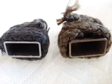

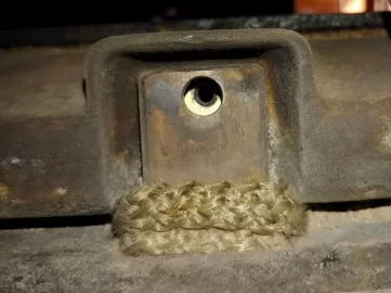

Various photos of the new part. And one photo I took of the old part in the stove I took about a week ago.

So some more information on the new part. The installers said they couldn't get the bolt out that held the old LPAO in place. They speculated that the head was stripped. I bought a 5/32 hex bit today which is needed to take the bolt out. I had it through the front hole to the back of the LPAO and sure enough it grips onto nothing. It's facing into the stove so you can't see anything so I stuck my phone into the fire box and tried to take photos. In the photos I couldn't see any head there. So maybe the head wasn't stripped but sheared off. If it was sheared off there should be nothing holding the LPAO in place so I tried using some needle-nose pliers to pull it out. Sure enough it came right out. As far as I can see the new part is identical to the old part. It sits in a little trench quite snugly. At the bottom there is a small hole for the air to come up through the LPAO. I think if the head had been sheared off it would probably have been too large to go though the hole at the bottom of the LPAO. I looked at the parts diagram and list and the bolt is item 57 part 4800-2132. The bolt is used elsewhere including holding the slider for the front air control in place. I took that bolt out to see if it would screw into the threaed hole at the back of the LPAO cavity. It screws in fine so I don't think the LPAO was ever bolted to the stove as it is supposed to be. The new part apparently didn't come with a new bolt so I can't bolt either the new or old part back in without stealing from elsewhere on the stove. I can't see if the LPAO bolt hole dead-ends or whether it goes straight through a threaded metal part. Presumably if the latter that might impact the airflow. Or maybe not. I have no idea if this is significant. It seems trivial but an indication that maybe there were some assembly issues. One wonders what other parts might not have been assembled correctly.

Old LPAO installed and removed. I stuck a vacuum hose in the cavity to suck out any ash and dirt.
[Hearth.com] MORE Hearthstone Green Mountain 60 - ISSUES [Hearth.com] MORE Hearthstone Green Mountain 60 - ISSUES [Hearth.com] MORE Hearthstone Green Mountain 60 - ISSUES
Old and new LPAO. They appear identical to me.
