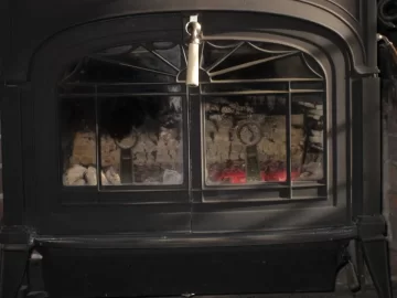

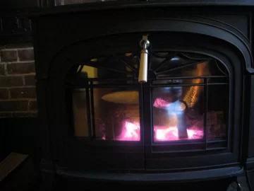

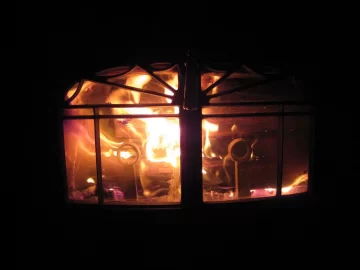

If it helps, some views of the show in an Encore. You definitely wont get the kind of flames a burn tube non-cat has.
First shot is firing the load after loading up a full load for the overnight burn.
Second shot is cruising at mid air - around 550F.
Third is cruising at low air - around 400F.
I can get it to cruise as low as 375 continuously... But you need to have good wood, a good bed of coals, and absolutely PERFECT gaskets all around. It was the last that I struggled with on this old stove. Hopefully a brand new one wouldn't have trouble.
