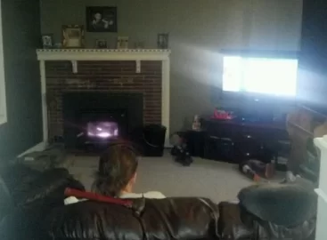

Sorry about the crap picture. Thought about a free stander since I have asked stuff before but I feel that the area is too small

No one liked my crappy pic :-( Oh well, think I've changed directions again! Too many choices
Tell the gal on the couch not to suddenly slam her head back on the couch, that hammer claw won't feel so good stuck in the back of her head.... ;-)
