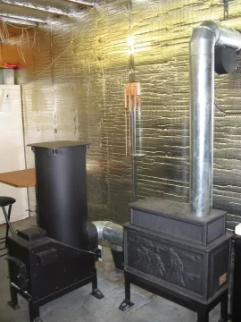

Recently completed construction and test installation of of a rocket stove type heating system.....The rocket unit supplies hot combustion gas to the system while generating radiant/convective heat to the surrounds......Gas then exits rocket unit via a crossover tube and enters a secondary heat exchanger/heat bank before exhausting....Secondary exchanger is actually a rebuilt, resealed cast iron stove affording three effective passes for exiting combustion gas....Test burn results (averages) as follows: Top plate of rocket unit---695 deg. F avg., Rocket casing---578 deg. F avg., Crossover tube---525 deg. F avg., Cast iron stove shell---275 deg. F avg., Exhaust outlet---145 deg. F avg.
Unit incorporates a Tjernlund AD-1 draft inducer to assist with cold light-offs and to counter adverse wind (pressure gradients) conditions respective of the through-wall exhaust configuration.
Unit was designed to burn any quality/type of wood and will undergo exhaustive testing this winter to determine fuel consumption, thermal output and overall operational characteristics/flaws.....Theoretical maximum fuel consumption is 1/4 cord per season (6 months).....I've included a photo of the complete unit in its current test configuration.

In the picture it looks like aluminized bubble wrap on the walls......isn't that combustible and very close to the radiant stove?
_g
Manufacturer's specs. rate that specific insulation for 180 deg. F max.......There is no fire rating given for it.....Before installation I subjected samples of it to some rather rigorous testing in the shop......A propane torch flame, directed at it from a distance of 6" only managed to melt it.....It took direct contact from the flame to initiate slow combustion of the plastic......Not to say this is the best stuff to use in a residential (or any) setting.....Stone, concrete or non-combustible backer board would definitely be more appropriate not to mention "code-worthy"....Bear in mind that the unit is currently being tested under shop/lab conditions by a qualified/trained engineer.....The test parameters require walls and ceiling to be covered with a material capable of reflecting radiant energy....To that end, the FBF insulation turned out to be the most cost effective expedient....To date, I've had no issues with insulation degradation during testing BUT time will tell.....BTW, that secondary HE is 12" from the insulation and runs at 225-275 F; a good litmus test for the FBF.......Future plans (if this system proofs out) are to encapsulate the unit inside a fireproof, insulated, reflective plenum chamber and duct the heat to the desired location(s).....All of that said; thanks for your safety concerns.

I don' t think you'd heat much of a space with 1/6 cu.ft. of wood per day.
Edit: there must be some condensation in the flue too?
Theoretical fuel consumption is what the tests will prove or disprove.....To date, it appears as though the unit will operate (fire) on a 20% duty cycle......By that I mean that once up to operating temperature (about 20 minutes) it will be fired for a 15 minute interval then shut down for a 60 minute interval....15/75=.20.....The heat bank located in the rocket unit along with the secondary heat exchanger's mass will give up their stored heat during the "down-time".
Condensation is one of the issues that will be addressed during testing......So far, no condensation or precipitation has been noted anywhere in the system....Third stage combustion temperatures in the rocket generator are running about 1,800 deg F and appear to be generating 100% quality exhaust gas.
Um. Looks like the (single wall?) flue pipe is penetrating the wall adjacent to a combustible material (bubble wrap). A chimney fire in that flue, and the plastic in contact with the flue will go up. Whether that flame spreads to engulf the entire space will depend on the fine engineers at the reflectix corporation of america.
And, whats behind the bubble wrap....more combustibles?
Give it up woodgeek. Arguing with an engineer is messier than peeing into the wind. ;lol

But if the stats are intended to represent something close to a final production stove, they just don't add up.
Exhaust outlet---145 deg. F avg. *** Unit was designed to burn any quality/type of wood ....Theoretical maximum fuel consumption is 1/4 cord per season (6 months)
1/4 cord of oak at 20% MC has about 6 million btu's (or make it 8 million assumed for 145F stack temp compensation). That's 33-45,000 btu's/day over a 6 month period, or 1,400-1,900 btu/hr. And since the stove is designed for any quality/type of wood, for oak reduce that by about 50% for green wood, and if the wood is pine, reduce the dry/green btu's another 40%. That might be enough btu's to heat a single room in a cool/cold climate. Keep in mind that a 1500 watt electric heater (near 100% efficient) provides about 5100 btu/hr, about 3 times the maximum btu's the rocket stove is spec'd to provide. I don't know of anyone who can heat a house with a single 1500 watt electric heater, and the rocket stove design only provides maximum about 1/3 the btu's of the electric heater.
Next is stack temp - keeping in mind that the rocket stove is intended to burn any type/quality of wood.. The vaporized water from boiling off water in the wood (seasoned or green) and from combustion has to go somewhere, and that vaporized water at 145F going into any chimney in a cold environment is going to condense to liquid -- a matter of physics, not stove design.
So, interesting concept but at this point I would have to conclude not practical or feasible.

I myself would be concerned about the use of what appears to be galvanized flue pipe where it might get hot enough to create the potential for zinc metal fume fever. In general we're a safety-oriented bunch so you'll need to endure those criticisms first before the technical aspects can be discussed.

Absolutely outstanding.....Didn't expect such a volume of constructive input to my post this soon......Many thanks to all.
Let me address a few issues/concerns:
Safety: This project is being conducted in a controlled, industrial environment....The unit is actually set up in a test cell that was formally used to house my hydrogen heat treating furnace....The cell itself is constructed of 8" reinforced concrete (like a pillbox) and equipped with numerous safety/monitoring features designed to suppress fire, evacuate fumes and relieve excess pressure....Since this is a prototype project, there are still LOTS of variables to be explored; many of which could present serious safety issues....Definitely NOT a project for hobbyists.
Unit construction: Insofar as the unit is a prototype, a great proportion of the material utilized consists of short ends, drops and various components left over from other jobs....Semipro voiced concern about the use of galvanized, single wall duct pipe/fittings for high temperature application....The photo is somewhat deceptive in that respect....The duct pipe/fittings were actually fabricated from 30 gauge, T-316 stainless sheet....Having a completely equipped fabrication/machine shop at my disposal is very advantageous.
Operating parameters: Lots of input here from folks who have obviously been doing research in this area.....Several have commented on the unusually low exhaust temperature with regard to precipitation/condensation in the breaching duct.....The 145 deg. gas temp. occurs ONLY when the draft inducer is in operation....Once the unit attains operating temp. (15-20 minutes) the inducer is shut down, flow/pressure stabilizes and the system goes into natural draft mode.....At that point, the breaching temp. stabilizes at approx. 220 F.....The AD-1 inducer is designed for 5"-8" round ducting and is well over-capacity (at its lowest speed) for this system....In order to compensate for this, I installed a bypass system on the suction side of the inducer to lessen the effective air flow.

: Everyone's arguments regarding fuel and its calorific content are consistent with facts/statistics/science.....I'll be the first to admit that I'm bucking the tide on this issue.....Hopefully, the design/construction of the rocket unit will get me close to that "1/4 cord goal"....The 20% duty cycle I mentioned is an absolute worst case scenario....Previous test firings indicated that the heat banks (primary and secondary) effectively retain/radiate for almost 3 hours once the fires are extinguished.....After 2 hours of downtime, the outer casing of the rocket unit registered 250 F in an ambient environment of 75 deg. F.....How this will all shake out remains to be seen....For testing, the heat will be force-ducted from the test cell (10' X 15' plenum chamber) into my 750 SF office area which is moderately insulated....I plan to have Bermuda shorts as well as my woolies and a parka handy during the testing phase just to cover all the bases.
