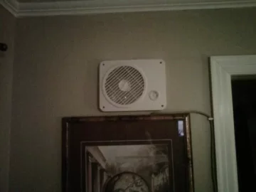

my pellet stove is in my living room, which is connected to kitchen. i need to find out a way to transfer the heat from one room to another. what are you guys using. i tried a 10" fan and didnt get any real results?

I use a small fan to move air. I put the fan in the cold room doorway on the floor blowing cold air towards the room the stove is in
Yep, like Bob said..... Move the cold air and the cold air will move the warm air.

pretty good discussion of approaches in this thread. i posted pics of how i do it.
one room is pretty well isolated in my house. (at the end of a long layout with a narrow bottleneck)
there are exceptions to the general rule of fan on floor blowing cold air back to the stove.
but so many people have great success with that approach, i am in no way saying my way is better. it's just what i had to do to succeed.
at least you can see how different situations get handled by different people.
in general, the idea of a convection loop is key.
how you are best able to achieve that can depend on the particular layout of your house and it's passages and other factors. (two stories, large or small home etc...)
i will say that what i finally came up works very for me. it was problematic to say the least getting the back bedroom warm without having the stove room absolutely roasting.
now it's pretty much on demand. and i can control the back bedroom temp like i'm turning a dial.
luckily my wife doesn't balk at the fans hanging in the doorways. they are out of the way. and nice and quiet set on low.

Look at Through the wall fans.
Broan makes some (I have a #512) and also a Tjernlund Aireshare AS1. Love them both. Only used for bedrooms. But helps move air throughout the other rooms adjacent to those.
