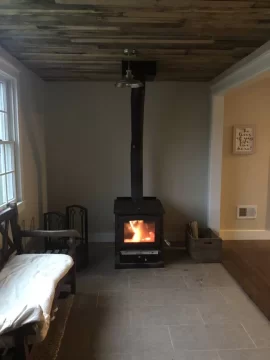

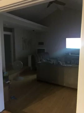

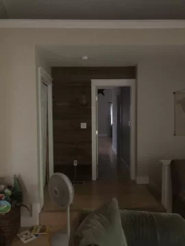

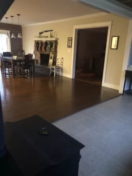

The pictures are not in order so the bottom photo is walking in the front door, the first photo is a picture behind the stove pointing towards living room, second picture is living room to bedroom and third picture is the hallway in my room (this is where all the cold air sits). I agree that 67 is a comfortable temperature however the room rarely will sit at this temperature, as soon as the fire calms down the temperature in the room drops enough to kick the heat on. In the pictures you can see the tower fan (set on low) pulling the cold air out of the room and it seems to be helping but it’s in a very inconvenient spot and isn’t asthectically pleasing at all

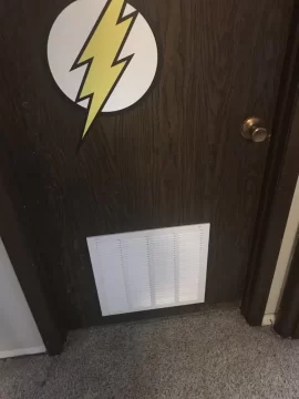

This is exactly what I did in my sons room. Except I had to go through the attic with insulated duct and the inline fan. It works great. The only stumbling block I ran into was when my son got old enough that he wanted his door shut. Lol.
So I cut a hole in his door. Wife made me put the cover on it.
