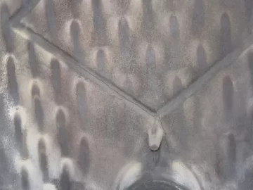

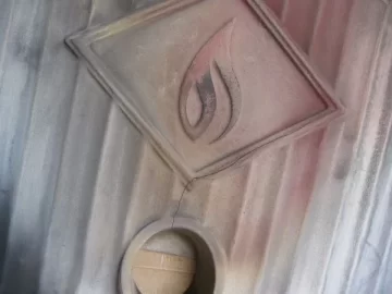

Too funny, I came on here to say that I discovered a cracked baffle this morning while cleaning and there is already a thread going on it! As others have said, the crack starts at the drop tube, goes up to the diamond and continues up the right side of the diamond. I was going to post a pic of it but it sounds like everyone is already quite familiar with the issue. For the record, I purchased mine in October and have put about a ton and a half through it. My dealer is closed today, so I'll have to talk to him tomorrow about it. In the mean time, is it OK to run the stove with a cracked baffle? I probably will just leave the oil boiler running for now, but it would be good to know.

jtakeman said:
I have only seen a pic of the flacking baffle. By all means post one up for us non quad owners. You know what macman say's. No picture it didn't really happen :lol: just kidding. We believe it did as there are quite a few that have had the issue. A photo would seal the deal though. :-)
I thought you might say that :-)

QuadraBurner said:
jtakeman said:
Yep sure is cracked clean through even! Hope you get the new one quick, Don't need any delays in recieving it from the dealer. Weird the way it follows the diamond around. Has to be a parting line or something in the casting process messing this up. Or just plain old sub standard material there using.
