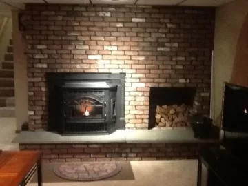

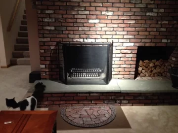

Just had my Mt Vernon installed. Now I just need some cold weather! [Hearth.com] Mt Vernon AE vs E2  Pros/Cons[Hearth.com] Mt Vernon AE vs E2  Pros/Cons
Looks great. Cold weather isn't to far off I am afraid.
Looks great! Fired mine up a few times this week to take the chill out of the air.
Thanks.
I know it really isn't cold enough for a true test, but this thing is throwing off a lot of heat.....and it is very quiet.
