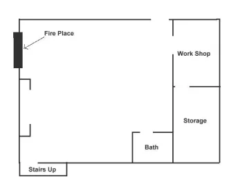

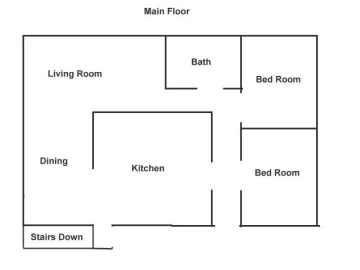

It doesn't look like a lot of heat would make it's way upstairs. The staircase appears added on the side of the house. I'm guessing it's unheated and perhaps a bit chilly?
If it were me, I'd still want a mid-sized insert assuming it would fit in the fireplace. The PE Pacifc D1, Hearthstone Clydesdale, Jotul C450, Regency 2400i are some options. There is no need to run the stove with a full load of wood all the time. But when it's really cold or when you want a long lasting fire, the bigger stove will do the job.
However, if he's set on the original 3 choices then I'd probably get one with a blower. I think that counts the Morso out. If he orders a Regency or the Country, be sure it is included with the price. It's something like $250 for the blower "option". This is standard on PE, Hearthstone and Jotul inserts.
Thanks BeGreen!The stairway is to the side but stairs are open to the top level,but still think heat will have hard time getting upstairs. It looks like he will be buying from the same dealer as i did.They carry the regency,Quadrafire and harman stoves.I can give him a choice of these three!
