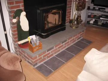

Would you be kind enough to share with me what type of mantle you have on top of the stove in your picture? My set up is almost just like yours with the square blue stones and raised hearth (my raised hearth portion is capped by brick though). I may have to remove the wood mantle and replace with a non-combustible one to meet clearance code. I'm trying to decide what to replace it with - thinking bluestone. I was hoping to see your fireplace including the mantle - it is very pretty and I like what I can see in your picture! Thanks if you can!!
PS- I hope your dad's install gets finished soon and he is happy in the end. We are considering the exact same insert. Good Luck!

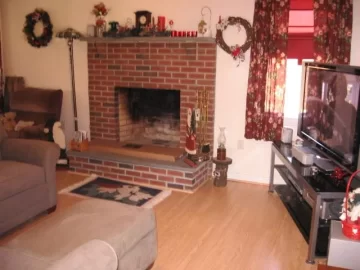

Here is a before and after pic of my setup.I have a harman insert!dad didn't get one like mine because of alittle too big for his fireplace.I had plenty of open space for my installation!I have been reading your threads!hope you find what your looking for.I will take a pic of my dads regency I2400 when installation is complete.

Stan... now I can see your insert better than possible in your avatar, nice looking an large looking too. How big is the fire box? Looks like it could be in the 3 cuft range. It also appears from the visible end-irons (or whatever I see through the glass) that your logs go in North South, not East West, the way my old slammer worked. My quadrafire, in fact all quadrafire inserts require logs go in E/W.
Hello Jerry! My firebox is 2.6 cuft!Its more wide than deep so i put my logs e/w.The harman is abit different than others!Its considered a downdraft wood stove (Has a after burner in the back instead of tubes on top for the secondary burn.
Stan.. seems I've got the jargon wrong/backwards. N/S must be with the logs pointing in/out of the fireplace and E/W is from left to right side, like most open hearth fireplaces are loaded. That being the case the Quadrafire inserts are all N/S, not E/W. Hope I remember this time, thanks.

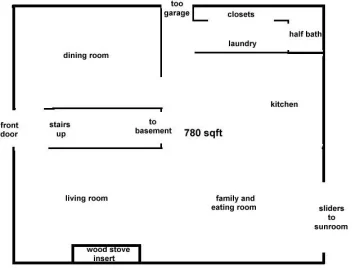

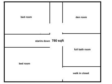

I haven't had much burn time yet (4 times) but when i had it going laying on the couch it didnt get too hot!! I would say upper 70s.Since my first floor is pretty open and have a good open area to the 2nd floor!the heat disperses very well.Here is a basic floor plan of my home.

Thanks Stanleyjohn! It looks great and is very helpful in trying to decide on our options... Looks like a nice comfy room, and I love the floor! Thanks very much for sharing!

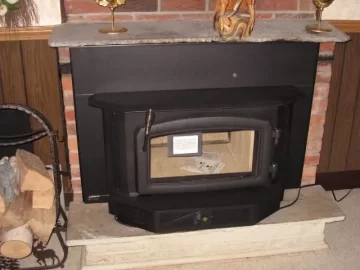

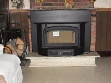

Went to my parents today and took a few pics of his new wood stove.Hes alittle pisst that its abit off centered!Installers will be back soon to center it!I'm surprised they didn't notice it when the did the job (note!! dad wasn't home when the install was done and mom just let them do their job and didn't notice).In the fall i will help dad put some ceramic tile in front for clearance.

Nice looking stove. Mom and Dad are headed for a warm house this coming winter.
