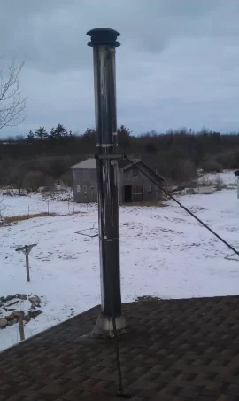

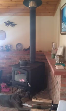

It is a straight pipe going up to the ceiling. About 55" of single wall 6" pipe going up to a cathedral ceiling on a single story room. After that there is about 7 inches of double wall going up to the ceiling. Then it goes outside as double wall and it goes an additional 9 feet outside of the house. It goes that high because several feet away the house is two stories so they had to go higher to compensate for the roof nearby. There is a damper on the pipe about 3 inches above the stove but we haven't closed it yet. I have attached a couple of photos. Thanks for the help. I hope it isn't anything major, because I don't have the money to do a lot after buying the new stove.

Welcome to the forum. I see you're in Watertown. You'll get plenty of opportunity to put your nice new stove to good use.:) Could your nearby two story roof be causing swirling wind/downdraft? Depending on prevailing winds (Which I know can be really impressive from the west there) and your roof construction, you may need even longer pipe.

On a side note, make sure you go through your englander manual well to make sure your setup meets all of the clearance to combustibles for walls and flooring. I can't tell from your picture if that brick wall around the stove has an air space behind it or not, but if not, you may have some issues. Also, does the brick work continue under the stove as the hearth pad? If so, again refer to the manual and make sure what you have meets the specified requirements.

Screen on the chimney cap is kinda dark. Hard to see if it's partially blocked in that pic.
With that short a chimney you're not gonna want any restriction there at all.
There is no screen. The angle gives it that appearance. I do need to clean it though. It is a royal pain in the butt to get to.
