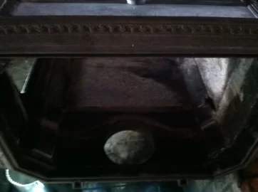

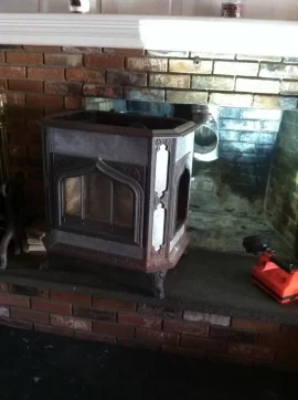

Here are a few pics taken today. The chimney guys were able to get the baffle out like it was a toy (it's nice to have a chimney guy who's also a firefighter) AND set it on the hearth. So here it is, just a bit off center as they're still working. The top, firebricks and door are off for ease of moving.
Also included one called "Look Ma, no baffle!" - pic #2 showing the inside from the top.

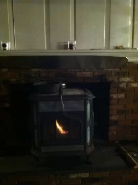

So here are pics of our first small fire. We kept it going with 2-3 splits reloaded twice between 4PM and 11PM last night. Stovetop temp came slowly up to around 400 and this morning it was still at 200 at 7AM. Today I loaded it up with 4 splits and a Bio Brick and it went right up to 450 within the hour, cat engaged, and it actually hit almost 600, with nice steam rising out of the flue. It's neat to see the steam - my next door neighbor has a wood furnace that has thick white/gray smoke that really smells of wood smoke (I like that smell) and standing outside this AM at 18 degrees I could see his smoke and my steam...cool.
The rooms in my house are drafty and an ongoing project, but it's actually comfortable in long sleeves and we've yet to do a full load in this stove...so yay.

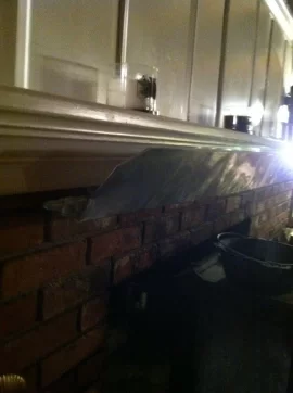

The first pic shows the first fire....the second pic shows our roof flashing heat shield - recommended by Woodstock - since we have only 12 inches between the stove and mantel.

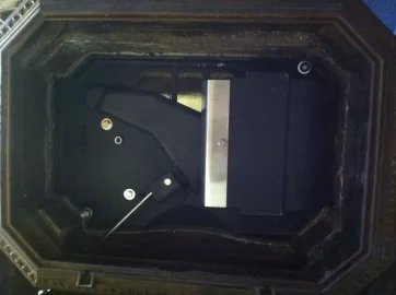

Adding a pic of the inside - new baffle, combuster, hood and heat deflector...thought I did this earlier but I guess it didn't take...

Thanks for the update. I kind a like the 201 baffle better than the 205. The bypass is towards the front instead of the back like the 205 so it won't send as much heat up the stack in the bypass mode. There is also a good amount of room on the left side to use as a small oven if you would like to wrap up some hobo potatoes in some tin foil and throw them in there.
