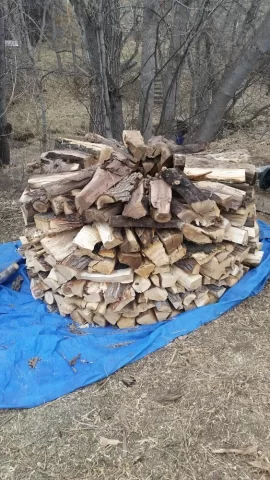

agreed, especially as it settles, it will want to collapse. You can see a few pieces running horizontally, which help keep everything together.
[Hearth.com] My first holzhausen

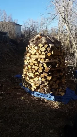

This one has been standing since February, and is noticeably shorter now :)
I have a few more piles out back that I need to finish stacking, and I am debating between traditional stacks or holzhausen.

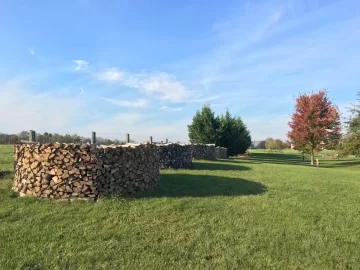

Don't worry man, my first one collapsed since I didn't maintain the inward cant...you can do it!
These ones have been going strong for a solid 9 months now:
