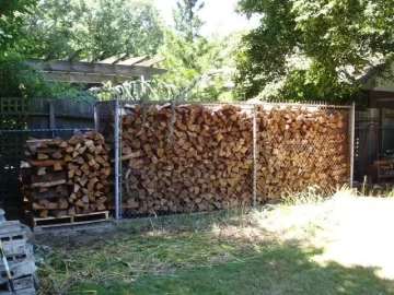

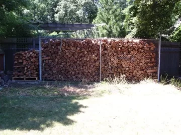

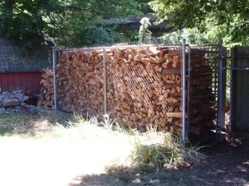

Well its all stacked.... Since this is my first time is there anything I need to do to make it better? Should I cover it and if so When? The guy I got the wood from told me it was cut and split in the early fall of 2007.

Looks good, I'd just cover it later in the fall.
Take the fencing off the front and make three more rows like that and you will be good to go.

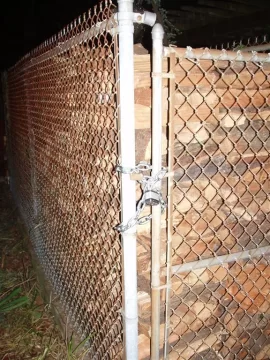

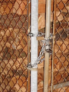

My wife thinks we should chain it up with the way the price of wood is going she might be right. My father was at work the other day and when they went to leave about 6 of the guys cars were making this horrible sound. Some one stole the catalytic converters off of 6 of the guys cars in broad daylight! I might come home from work one day and find my wood gone. HHMMM Yeah thats why its in there Im going to lock it up....Umm I did that on purpose...;-)

Is that one row or two in the fence. How long, how high and what are the split lengths?
The split lengths are 18 inches.
I have two rows deep so that's 36 inches deep by 192 long by 66 high in the fence
out side the fence area I have 36 deep by 40 by 42
so thats 264 in the fence and 35 out side the fence giving me a total of 299 hmm looks like i got shorted quite a bit?
3 cords should be 384 correct? can some body confirm this for me before I call up the guy and tell him he shorted me!

You are right. That is a total of 2.25 cords (roughly) according to my calculations.

Yeah what Todd said about buttoning up in the fall...maybe Nov.

Looks very nice Andy99. The fence made a perfect place to stack the wood. It certainly won't fall over and will be easy to throw a tarp over for the winter.

Looks like 2 1/3 cords to me.
2.337 cords (or thereabouts). Did you compensate for the temperature of your tape measure when you took the readings?

OK I just had to do it!
