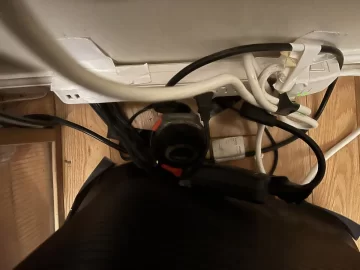

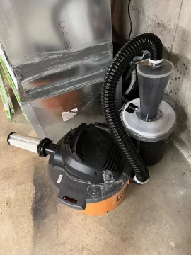

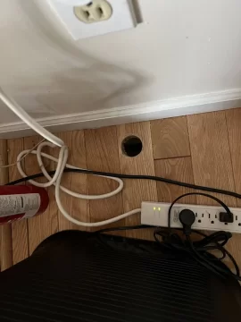

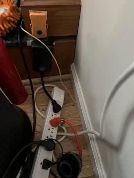

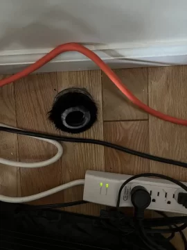

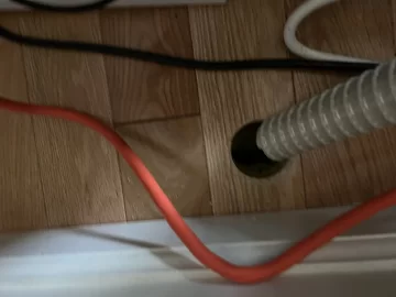

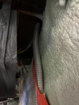

For the past 11 years, basically every Stove cleaning week, I have lugged two different Ash Vacs and one Shop vac up and down the basement stairs. I also go up and down the stairs getting pellets from our two storage bins. I needed to find a way to reduce my trips up and down the stairs! Two years ago, I added a Cyclone Dust Buster in-line attachment to my shop vac (One of the best and smartest moves I had made at the time) *Note, I can follow up with anyone about my version of the Cyclone or the even better New version in another post. My problem with adding this piece of equipment to the shop vac, is that it made my stair climbing even more a royal pain. The solution…..Drill a hole :cool:
So besides the Vacuum hose which I wonderfully just pull out of the hole to the desired length, I had to run the shop vac power cord up the hole as well, because it plugs into a Fast Cap universal remote control. It works perfectly! Pull the hose out, hit the little remote switch, Varooooom! The RVC box and remote have a separation range of up to 100’, so I could have plugged my shop vac and RVC box into an outlet in the basement but Fast Cap warns its customers that "Stray radio waves/signals could inadvertently power on the shop vac"! Probably very rare, but I wouldn’t want to risk a fire caused by an unattended running shop vac…….

Hi Ray! My Stove (guess you didn’t catch my signature) is an Enviro M55. I’m on my 3rd Vac….sold my first, burnt out the motor on my Power Smith. The beauty of the cyclone is that 99.9999% of the ash goes into the Cyclone bucket. The only time I empty it is at the end of the heating season. You are fortunate to have all your stuff nice and close and no stairs!
Bill
