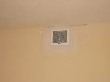

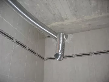

The first one is the ducting on the first floor. It exits the daughter's bedroom into the bathroom. One duct is cut away to blow into the bathroom, while the other one continues all the way (see second picture) to emerge into our bedroom (third picture). In those pictures you can see the roof of the bathroom. In the near future we're going to make a soffit (false ceiling?) and the ducting will be hidden there. The duct which exits in the bathroom will have a neat vent in the soffit.

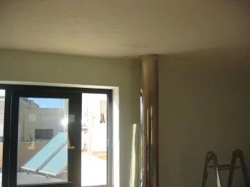

In the following photos you can see the flue (still bare for now) in the second floor washroom. The window there is the reason why the first 9 feet of flue downstairs had to be flexible.
The hole through which the flue passes has been filled. There is insulation and it was also finished with high temperature cement.

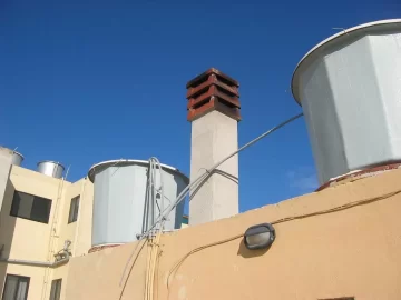

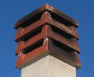

The last photo is of the chimney. I noticed quite an amount of soot, is that normal?
I would say, no its not normal, especially if you've had several hot fires going. Could it be the amount of cooling that is happening to the flue by the venting/drawing heat off the pipe to heat the area? Based on what you said before - I doubt its that you are burning wet wood.
I was going to ask before what those 3 (assuming) clay pieces were for... now I see they make the chimney cap, which could make it hard to clean.
Can you get a closer picture as to what you think might be a lot of soot?

Here's a close up of the chimney. The 'clay' parts are made of what the supplier called 'lava concrete' if I remember correctly.

OK... still hard to tell from the picture, but by that closeup, I don't think I would be too concerned about that much (seems to be only a little) creosote. Kepp an eye on it, keep the fires burning relatively hot (where you don't see a lot of smoke out the chimney) and use dry wood, and you should be ok.
Are those cisterns on the rooftops? I would expect that those lava concrete chimney cap pieces would be blackened. I would not expect them to be dribbling black liquid onto your nice chimney.
Um, yes those are water cisterns. One of them is filled by normal water supply, and it provides water for the solar water heater. It's good to have it like that because the normal water supply here is under pressure and might damage the water heater. The other one gets water pumped into it from our well, and that goes into flushing the toilets, and stuff like washing the floors, watering the plants etc.
The stuff on the chimney appears to be soot. So I understand soot is not creosote and creosote is liquid? Sorry for my ignorance. Fireplaces are not common here - first of all the winters are rather mild, and secondly were I to BUY the wood it'd be more expensive than heating my house with airconditioners...
Well... this is probably oversimplifying a bit, but there are different stages of creosote, the one you most have to be concerned about is the "third stage" which would appear to be a hard, tar-like shiny material. It is the stuff that is most likely to cause a fire in the chimney.

Hogwildz said:
Flexible aluminum? That just doesn't sound right or healthy to me.
I think she is talking about the air movement ducting, not anything to do with the smoke venting - remember her setup acts as both a stove and a furnace, so there are hot air ducts as well as the flue.
AFAIK there is no reason not to use aluminum for HVAC type ducting.
Soot is mostly carbon particles and as such isn't a big problem as long as the quantity stays down, though it does contain other stuff that makes it mildly unhealthy to have alot of contact with it (mostly only a concern for chimney sweeps and so forth) As long as it doesn't get really heavy, it isn't a big problem and a certain amount is normal.
If those cisterns are not covered, I might be a bit concerned about how close they are to the chimney, especially the one you sort of suggested might be used for drinking water, but I don't know just how much of an issue it really would be.
Creosote is a mix of soot and other unburned combustion byproducts, including wood alcohols, tars, and other nasty stuff along that line, and is found in several different forms and consistencies depending on just what mix of stuff is in it, and what conditions it forms under. A modern stove with secondary combustion, when operated properly, should NOT produce much creosote, and mostly what it does produce will be at startup and refueling times. A large part of the modern stove design is to finish burning the material in the smoke which would otherwise condense into creosote. One of the forms that creosote can take is a black, tarry, asphalt-like liquid that tends to stain and smell vile, Some folks have had problems where they get buildups that drip out of their chimney caps, which I think is what Highbeam was referring to.
As long as you operate your stove properly, you shouldn't have a big problem with it, although pulling heat off the pipe the way you do in your daughter's room might cause some problems. I would plan on cleaning the chimney at least once or twice a year to make sure you don't get an excessive buildup.
You do seem to have an unusually tall chimney height, I'm guessing well over 30 feet, which can cause overdraft problems. However your relatively warm climate (compared to what most of us are used to) will tend to reduce your draft, so it's hard to say what the total effect will be. Watch for signs of overdraft, particularly a tendency towards over-firing, or a lack of the air controls on the stove to effectively change the way it burns. If you see signs of this, you might need to add an extra manual damper to the flue in order to further reduce it's draw. I wouldn't worry about it immediately, but keep it in mind. If you do want to put a manual damper in, it will probably be easier to do so before building the surround for the stove and pipes.
