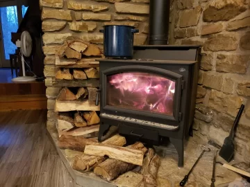

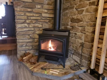

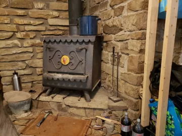

Hoping this thread helps some folks. I upgraded from a modified (not by me) old Earth Stove to the Liberty. Backstory: I bought the Earth Stove used almost 20 years ago, with 6' of Metal-Fab double pipe for $150. I bought all the other pieces (more pipe, cap, flashing, ceiling box etc) directly from Metal-Fab. It has served us VERY WELL...Earth Stoves are beasts (2500 feet of sprawling ranch-style house). But it was time to upgrade due to inefficiency and physical failure of the stove (air control no longer working). I was looking at the Liberty and the Green Mountain 80, I went for the Liberty. It was installed today, and I had the pleasure of doing the paint cure burn (it was 75 here, so all windows and doors were open). I spent the day playing with the bypass, the air flow, and loading different size splits in different orientations...I'm so giddy. I'm looking forward to the increased efficiency and ease of a modern stove. Big cold front coming this weekend, I think the electric furnace will be getting a break.

Great looking install! Should be quite the upgrade.
It looks great there and a big improvement. Both the old and new stove look like they are right up against the stone? How thick is the stone behind the stoves? Is there an air gap behind the stone and the wall?
Stone to the right is the old exterior of the original (1942) one-room cabin chimney (several feet thick, all stone and mortar). Stone to the left is the old exterior wall of an added bathroom (1965), 15" thick, also all sandstone and mortar. With the Earth Stove, those walls radiated heat for hours :) I'm guessing they won't get as warm with the Liberty due to the heat shield.

I said I would update, so after 3 months of burning in the new stove, I'll keep my word ;). I've definitely had to adjust my "usage" of the stove (reload schedule, split size, air control, etc.) but I could not be happier. Now that winter has properly arrived, I don't think I've seen much of a decrease in wood consumption. I'm 100% certain the heat shielding is why as the corner does not gain any heat at all and the double wall pipe isn't radiating any meaningful heat either. I also no longer have a key damper. However, rather than loading wood every 3-4 hours, we are loading every 8-ish and not worrying about over-firing. Our rain cap/spark arrester is almost spotless (vs. the old stove when I had to clean the flue 2-3 times a season). The continual, consistent heat has kept our expensive electric furnace mostly dormant this year. I did use the insert located on the other end of the house when it was "cold-cold" (highs in the teens lows in the singles or negative for a week straight), but that was mainly for comfort. All in all, I am so glad I bought this stove. For eye candy, here is a pic from an hour ago...you can see the size of splits I'm using (smaller than the last stove) and the amount of wood we use daily. I bring in a wheelbarrow from the shed every day after work, stack it up so it warms up before we throw it in. All of the wood you see will be replaced in 24 hours. Air intake just a smidge open from fully closed. Reloaded at 5:30 pm.

Interesting development this morning at 1 am...my 18 year old son woke me up, stating the kitchen floor was "hot and bubbly". I got out of bed and as soon as I left my bedroom at the opposite end of the house could smell the stove was running hot. STT was cruising around 650 and firebox was completely firing. My wife did the overnight load at 11:40 and came to bed. The load was a mix of very seasoned oak, beech, and walnut. Air control wasn't as closed as I do for an overnight, but it was 85-90% closed. It was 90 degrees in the stove room (kitchen), which I've never seen. The warmest it gets in there is 80-82 (even when running hard when it's colder out). My biggest concern is my floor directly off the front of the hearth, which is laminate planks. That spot typically gets warm due to the radiant heat through the glass, but last night it was almost too hot to touch and had developed a couple large "bubbles" (not actively bubbling, but rather air pockets). I wish I had the foresight to grab my IR temp reader. Hearth clearance is right at 16" from the door. The air bubbles were directly centered with the hearth, just off the stone/mortar from where the green lighter is sitting in the photo below. One air bubble was abour 5"X16", the second 5"X6". Other than the potential/assured damage to the flooring, should I be concerned? Are there any mats/rugs etc. that have insulative properties I should consider placing on the floor? Or should I just chalk it up to the cheap facelift flooring we bought to tide us over until we can remodel the kitchen properly? I'm not overly concerned about the flooring, but was very concerned about how hot the floor was.

I would be worried about the flooring in front of your hearth, do you have a fan on your Liberty.
