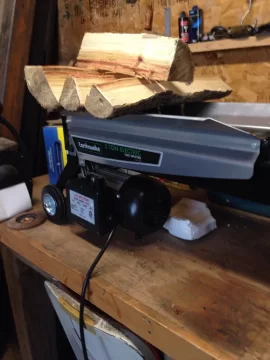

Saw this at Menards for $275. Seems to be very little info. specific to this little guy. Bought it yesterday, and assembled it after work, today. Many of the reviews I could find were years old, so I thought I'd post my experience, so far, and update over time, as I get more use out of it.
Some of the things I've found that are contrary (in my specific case) to some reviews I've read in multiple places. This may be a matter of change over time, or I may just be lucky.
1. The unit came full of fluid. Not shipped with minimal fluid. (Many older reviews stated this.)
2. Came with metal rimmed, rubber tires, not the cheap plastic ones in older pics of the unit.
3. All fasteners and fittings fit, and were in the proper place. Again, older complaints.
4. The welds ain't pretty, but seem solid. What you'd expect from cheap Chinese products.

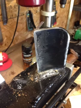

5. Wedge came very dull, but to be fair, the $1400 DHT is equally so.

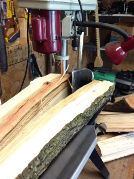

I split a few small pine and elm rounds, just to be sure it works, out of the box. Then I sharpened the wedge. The next few rounds split very smoothly, without really bogging the unit, noticeably. I wonder if this will help with the bigger stuff. Just can't stand dull edged tools.

Day two, and the little Earthquake does split wood, albeit slowly. Went through some pine, elm, and box alder, and it didn't bog or hesitate with any of it. The problem is, it ran slowly enough that I found myself getting bored. Also, as some here have stated, the splitter splits are much shaggier than those split by hand. Definitely going to have to bypass that two hands to operate thing, too. Very aggravating.
