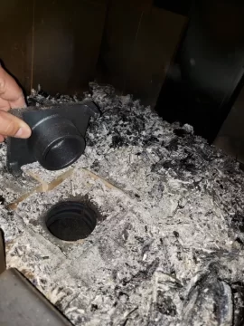

Also i attached a picture here, I'm not sure what's the purpose of this but i had it in place during the fire. Does it stay in place or do i remove it during fires?

That is the ash port plug. It stays in place except for cleaning. Clean out all the ash around it before replacing. You don't want air leakage there.
