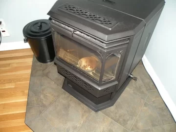

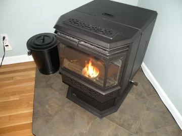

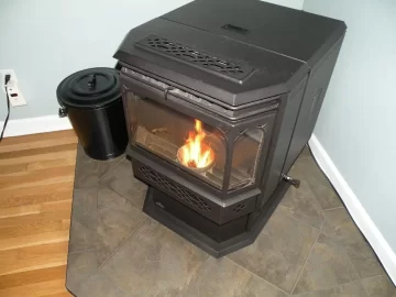

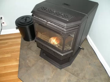

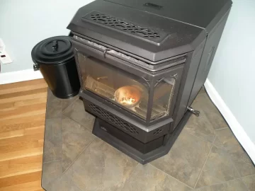

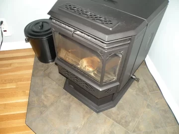

Glocke, I'm going to post a series of pictures I just took, featuring a "burn cycle" in my Napoleon NPS40, the free-standing version of the insert that you have. Right now the feed is on 4 (as recommended by the owner's manual) the convection blower/fan is on 3, and the damper is on 3. This is the type of cycle that you seek: the previous "load" of pellets is almost completely spent, but there are enough embers remaining to ignite the next load of pellets, and the flame builds until the pellets that have accumulated in the pot burn down to embers, with enough embers remaining to ignite the next accumulation of pellets. Your stove should be able to burn cleanly like this for a number of days. I just cleaned our stove this morning; previously we cleaned it on Tuesday, Christmas day. (Sorry about all of the pictures, everybody, but this is the type of series of pictures that helped me when I was trying to understand what a normal "burn cycle" looked like.)
  • [Hearth.com] My pellet stove sucks.....
... and for those of you who always remind me that "without pictures, it didn't happen!" here are the settings, and proof of temperature in the room. :)
Glocke, if you look closely at the first few "burn cycle" pictures above, you'll see the air holes in the bottom of our burn pot. Personally, I like to see this- it tells me that the stove is burning cleanly and that I'll have a couple of days of good burn before I have to clean it again. Keep working on it- you'll figure out what's not working and get it straight!

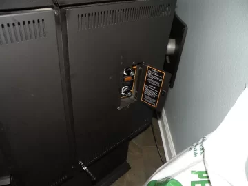

P.S. one more thing- I just read this recently on this forum- if you are replacing door gaskets on a Napoleon you have to get Napoleon-specific gaskets. The generic door gaskets won't work. Use the "search" box and type in "replace Napoleon door gasket" to see if you can find that thread. I need to go back and find it as well. We are going to have to replace our door gaskets too, eventually, and we'll need that information. Also, if you are going to replace the door gaskets, check your ash pan gaskets as well (with the dollar bill test) to make sure that they aren't ready to be replaced.
