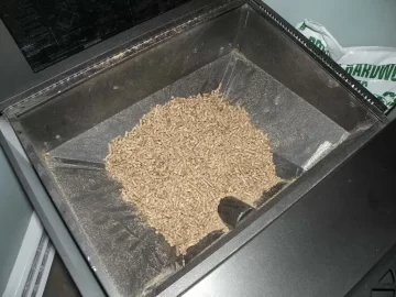

This is what remains in the hopper as of a few minutes ago. We started this burn yesterday at about 6:15 pm with a full hopper. That would be about 26 hours ago. The hopper holds 55 lbs. According to the manual, burn rate is in pounds per hour, and is listed as 1.0 to 5.0 on the specs chart. (I guess I never read that chart closely enough until right now- it clearly states: "Burn Rate (Pounds per Hour)** 1.0 to 5.0

looking at that picture i see what appears to be maybe a third to a quarter bag (hard to tell accurately as i do not have (nor do i need) the dimensions of the hopper, it ain't that important sweetie.

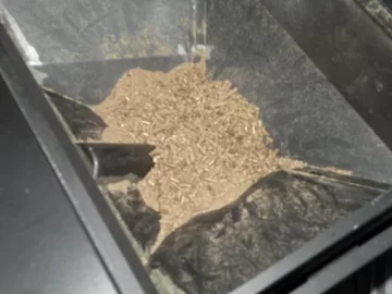

Right now we are at 28.75 hours and there are *still* pellets left in the hopper, see below. Not many, but the hopper isn't empty yet. I bet we hit midnight, 30 hours, before we burn through 55 lbs.

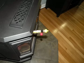

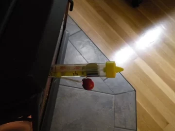

To that end, see my highly scientific candy thermometer stuck in the far left convection blower outlet, the "hot" side, of the stove. When I took the pictures, the thermometer read about 325'F. Right now it is at 310'F, but a few minutes ago, it was at 330'F. I guess the temp is varying with the height of the flame in the burn cycle. At any rate, I can't complain about a temp output of over 300'F, regardless of feed rate. :) And the temperature in the house is rising, without any assistance from the HVAC. Again, can't complain!
