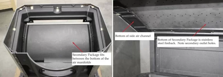

I spoke to them yesterday. It was suggested that I try a smaller opening for the secondary air control (they will send new plate) and to also check inside for proper alignment of the screen under the bypass damper. Apparently this needs to be properly located since it creates some airflow restriction. If it is not in place, it may create a greater draft than desired.
So they have different sized secondary air hole plates?
They said that there testing indicated the ones that they ship were the optimal for their installation however all installations are different and may require fine tuning the airflow.

I had this conversation with Woodstock at the BBQ. I was concerned the secondary plate did not close further, they said the plate that ships with the stove should work for most people, but there was an easy retrofit using a different plate. The recent post seems to confirm this.

Is this a picture of the secondary air plate being discussed?
Maybe a good test would be to temporarily block several of these air inlet holes (sheet metal screws) and see if the amount of air could be reduced as needed? Just a thought.
