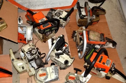

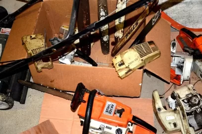

So far I have the 024AV, the 025 and the 031AV running great. I sold one of the 041 and 009 as "parts saws" on ebay and got just slightly more than what I've put into those 3 to get them running! Still have another 041 and two more 009 plus some pieces left to sell too. Keep on restoring them old dogs Burnt03!

Love what you are doing with those old saws, I get more satisfaction heading out to cut with one of my old rebuilts than taking my new ones out. I picked up all this Stihl "junk" from a young guy recently for $100. He bought out an old guys lawnmower repair business and didn't want to fool around with saws. All this was heaped up on top of each other in a big box!
$100 for all that???? Nice one!!
Never done much with small engines before so it's nice to be able to have something to tinker on and learn as I go with all these saws. Plus, I like making a ton of noise once I get it running, just so the neighbours know I'm still here :)
Reactions: MasterMech
$100 for all that???? Nice one!!..................................Never done much with small engines before so it's nice to be able to have something to tinker on and learn as I go with all these saws. Plus, I like making a ton of noise once I get it running, just so the neighbours know I'm still here :)
That's exactly the same with me, never worked on any small engines before about 3 months ago, was mainly interested in just tinkering, but its a full addiction now, I'm scanning the local CLs a couple times a day for a "fix".
Originally that guy wanted $150 for everything there minus the 024 & 025. I was mostly interested in the 031, hoping it had good ignition parts. When It didn't, I told him no thanks and went to leave. He said "ok, how about $100". I thought about it, but still declined since I really considered it mostly junk, and at the time didn't even know what the other stuff was (turned out to be 2-041 and 3-009). Thats when he said "how about if I sweeten it up a little", and pulled out the 024 & 025 and added them to the pile for $100. That did it, it went straight to my trunk!
I start on ebay looking for parts, but have bought some items from other internet "small engine repair" type places. Just google what you need, let your fingers do the walking!
Reactions: CaddyUser
Atta boy Boog, I'd have given him the $100 for the 024 and 025 alone. The rest is just icing.
Have you cut with the 024? With 3/8" Picco cutting gear, they are sweet little saws.
Yes, I cut with it Thursday. I've got an 18" .325 on it, it cut basicly just like one of my 025/250 saws, its 41.6 cc. I was thinking of doing just that, put the picco chain on it, but it has the same large format bars like the 026/260 saws. I guess it was the PRO saw before the 026 replaced it. My picco bars from my 191T would not fit it. If I'm right I could have used a .05 "3/8" bar right? As long as it was .05? But my sprocket is a spur one, for now, and it was .325. So I was going to put a rim on it, but it has the continuous oiler, and the rim sprocket hubs seem to be for the deeper ones needed for the adjustable oiler. So it looks like I'll have to do what I did to my one 026, put the adjustable oiler and rim kit in it for 3/8, then I could do picco. (or just put a 3/8 spur sprocket in it for the continuous oiler) Does that sound right?
..................................... Plus, every saw was free :).......................................
