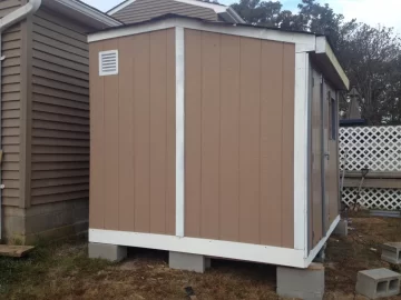

I'm not much of a handy man, but i did tear down a shed from someones property (legally) and put it up as my wood shed, it's about 10x10 but it's a total rig job, nothing fit together properly so I think it was two sheds mashed together at some point. I have it on blocks because we flood (BTW
So I get it all together and it's leaking very bad, to the point where all my wood is wet. Yes, i put shingles on the roof. I can only guess that the back part of the shed doesn't slope down enough or maybe not at all.
What do i need to do to shore this up, what can i use to cover the roof without throwing a blue tarp over it.
Any ideas? It's not leaking in the front, just the peak and the back. Wifey is not letting me spend any more money, so minimal costs is essential.

Spidey - Have you ever shingled before? It is very difficult to tell from the pic, but it doesn't look like the shingles were laid properly.
ETA - with the very minimal slope that you have, you may very well be better off with roll roofing (kinda like shingle, just in a big role) with a heavy overlap - maybe even seal the overlap with tar. The stuff is pretty cheap.
Hopefully @Hogwildz will show up. He is one of the onboard pros for roofing.
I can tell just from that picture your shingles are all jacked up.

LOL, The only shingling i've ever done was removing the old ones from the house behind the shed, I never installed shingles but it looked easy. Simply lay them on top of each other......I guess not!!!

From looking at your shed, you do not have enough pitch in your roof for shingles. What you need to do is go to home depot or a lumber yard and get you some roll roofing and put that down. Start at the bottom and work your way up. Yes that may be a little like tell a kid on how to do it. BUT I can tell you people have started at the top and came down, with rolled and shingles. Then wanted to know why their roofed leaked. And yes I roofed for over 20 years. Roll roofing use to come in rolls of 100 square feet in a roll. So measure your roof and get what rolls you need , a few tubes of tar and a couple pounds of roof nails.

You need a 4/12 pitch for shingles. I got away with 3/12, but it's pushing it. I think the roll on roofing or even metal roofing is the answer. For the meantime, you mentioned an aversion to blue tarps. Have you seen the black tarps?
Come to think of it, a single piece of EPDM might be a good fit for this roof. Drape it over the edges and secure it to the walls. The only hard and fast rule with roofs is that they must shed water. A single piece of EPDM wouldn't have any holes so it should shed water real easy.
