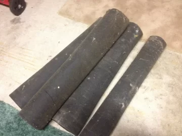

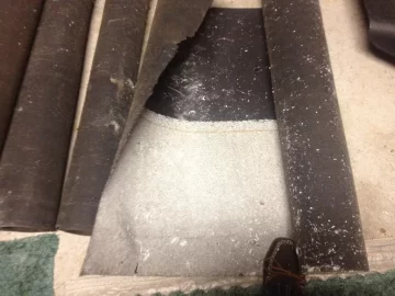

Ok, so a buddy of mine gave me extra roll roofing he had laying around, this still confuses me though. How is this stuff any different than just shingles, it looks like one long piece of shingle. Please see photo below.
So, how do i go about this? Remove shingles! do i lay something down before the roll roofing? Based on what you see , what should I do? Please.
http://www.wikihow.com/Apply-Rolled-Roofing

i guess this is what I'm looking to figure out. if the pitch is not enough for singles, how Will this be any different?
shingles have little dots of tar/glue to keep themselves glued down so water sheds off with pitch.
with roll roofing, if you've properly tarred and nailed the seam(s) water won't blow nor seep back up that slight angle.
leaking back in thru your roof material, if that is what is happening. Big IF.

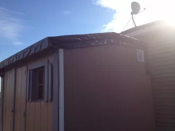

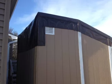

Ok, I tarped the shed. Looking a little ghetto.

I've absolutely had it. I tarped the shed, nice and tight, stapled down on the sides, no overlaps and somehow water is still getting in. Unbelievable. Heavy duty tarp from HD.
