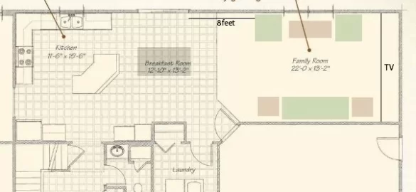

Here is the room. We want it in the space at the top middle that says "8 feet". The green is our couch and chairs, brown/grey are tables. The angle door goes to the garage. The far left is open to the dining room/living room, the bottom is open to the foyer which is two story to the upstairs hall.

I would throw Quad and Jotul in the hat for consideration if cast iron is on your list.

I would also consider the Enviro Boston 1700, the PE T6 and perhaps the Quadrafire Explorer II. FYI, we have the T6 in a ~300 sq ft living room in an open floor plan, 2000 sq ft total. No problem with overheating. The Jotul cast-iron jacketed stoves should work too.
