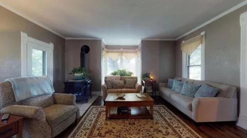

We recently purchased a 1880s farmhouse in Indiana that we are remodeling. In the home there was a Nashue wood stove that seemed to us to be improperly installed beings it was up pretty close against a plaster wall and sitting on standard tile without any heat shielding. As part of the purchase agreement we asked them to remove the stove. The stove is still in our possession just located in the pole barn on the property. As part of our remodel I would love to reincorporate a woodstove back into the home but the more I read the more confused I feel as it seems everyone has a different opinion on how to properly install them.

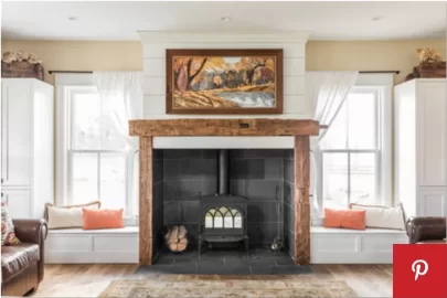

The hope is that we could put a single story addition on the south side of our 2 story home. With the 10 3 2 rules in mind would this be a smart idea to have it off of the single story 10 feet away or would we still have draft issues? Also, I attached a photo of what I will refer to as an alcove instal. I would like something similar but was told at a local retailer that to install in that way is not remoended and I was basically stupid for suggesting it.

Welcome. The old Nashua was a good heater and a tank, but a modern stove will burn much cleaner, putting out heat using less wood. And it will provide a beautiful fire view. They most likely had the stove in this location because it's where they stayed the most, though I would change the stove orientation 45º to face into the room. How open would the new addition be to the current floorplan? If there are a lot of obstructions then heat may not flow out of the room too well. That could mean overheating in that space if it is built well insulated and sealed.

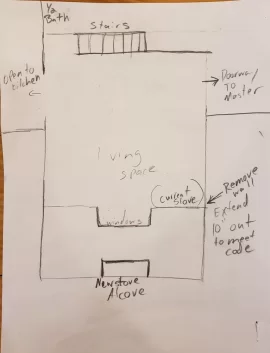

Can you post a sketch of the current floor plan, including the staircase and the current stove location. Indicate where the proposed addition connects.
That Inglenook design is a common request, but it takes a lot of planning to do it properly. The entire enclosure including the studs most often needs to be made entirely of non-combustible materials. For the stove shop they probably consider it a big pain. Our neighbors just tore out a zero clearance fireplace and she also wanted this look, until the costs and hassles were presented. They are now doing an open alcove instead.
Thank you for the reply and for clarification on the IngIenook.
Here is a super rough sketch.
This is a very centrally located living space with direct access to the stairs and other areas of the home.
