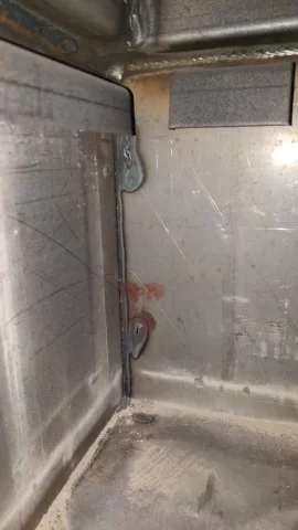

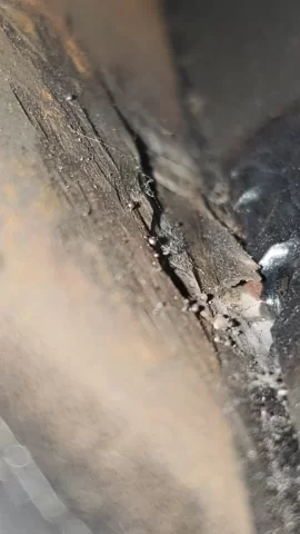

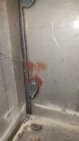

If i can get some opinions on what would you do. I have a englander nc-30 that has some bad welds. When the rear heat shield was attached they got a little hot and came threw the rear of the fire box. The stove was bought threw lowes couple years ago, but is new and just finished installing the cramic on the pad. Englander gave me two options 1. Have someone fix it and they will reimburse me. 2. I get it too their distribution center and they will exchange it.
I feel i found a good onsite welder which, said he feels like he can fix it and it should be fine. But i worry about the 2 other welds i can't see and feel like it should not of passed inspection.
It will not be easy to load and unload the stove if i decide to exchange it. But I'm sure i can figure it out. I just want to be safe and not have to worry about weak spots and problems down the road.
Any help would be great. Thanks

My vote would be to exchange. Like you said what's the others look like you cant see...
Exchange
You deserve a new stove - that's what you bought. It is a pain that you have to exchange it, but that's what I would do.
It will be work to move the heavy beast, but peace of mind with a hot fire burning in your home is worth the hassle of exchange.

Thanks for the input. That was the way i was leaning. Just pisses me off i paid for delivery and now i got to move it twice.Just dont get how it was not caught at the factory. It is my fault for not catching it sooner. I did look it over when it got delivered. But didn't do what my wife teases me for doing. She calls it checking the stitching.

I see the bricks are removed. Could this problem have been observed with bricks in place? I don’t remove bricks for the sake of checking things. Heck, I’ve never had the bricks out of my nc30 or the princess.
These stoves are cranked out fast with robotic welding, bending, and cutting. If one stove turned out bad you can bet a whole bunch made it off the line bad too. Hope they noticed quickly!

Both the holes are on the left side (hinge) and would be covered by the brick. I can't see the top right one but from looking behind the shield it looks as bad as the middle left one. The stove is older end of 14 build date. Just slowly been getting things done. Really slowly.

It's about 60 miles one way. The problem being its just the wife and me, with not a vehicle to transport. I can rent a truck and ask the neighbors kids to help me load and unload (timing sucks to figure it out) that's going to be a hundred plus gas. Pay someone to do it for me. But that's easy going to be a couple hundred. Is my busy season at work and only get a day off at best. Or i can hire a wielder get reimbursed and worry about what ifs. I know what i want to do. Especially after all your feed back, just trying to figure out a way.

I've been in the shop. Not a robot in sight. Just a bunch of hairy legged boys with hoods on.
