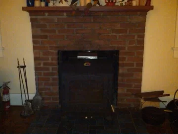

Well I had the long weekend to finish up things around the home. Finally pulled the old stove and installed the new to me (used) NC30 I picked up last year. Ran a brush up the liner and gave it a quick clean. Chopped 1" off the legs and installed them. Back in Sept. I sanded cleaned and repainted the stove. The stove is set back into the fireplace and is set on a TSC Micore stoveboard for this season (R=1.5) I had to go with a stainless 6" offset adjustable adapter to get'er to fit. Not my favorite choice but gotta do what you gotta do. I also cut the rear blower plate and installed the blower from my old stove to help circulate the heat.
I still have to cut the ceramic baffle boards to size, install them, and lastly install the fire bricks. Wife already warned me that it will be in the high 20's by the weekend :(
Sorry for the poor quality pic....dropped my phone in the pond I was duck hunting Sat. AM :(

Yes sir, it's a two piece overlapping block off....I also stuffed a bunch of Roxul up inside as far as I could reach. I used a thin door gasket and the supplied RTV and made a seal around the seam of the adjustable adapter. Was able to but two new ceramic fiber boards at a Quadrafire dealer for short money. Just had to do some trimming to get them to fit.

Don't worry john ,-3c night time low on saturday. It's coming:oops:
Looks great. There are a bunch of us on here that have stuffed a NC30 into a fireplace.
Thank you! Was tight going in but got it to fit. Was worried about the draft but seems fine.
