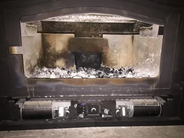

Where is the discoloration? Inside the firebox?

Attaching some photos. Wood pile again mostly 2-4 splits. Front of the insert with the discoloration and in the corners there seems to be drip marks. No clue from what or when they came about. Asked my wife and she is not sure either. Door showing glass dirty at the bottom. This has occured from day one. Never put 1 and 1 together until I did the dollar bill test. Figured that everything was fine because it is new.

The discoloration is just where some wood maybe had too much moisture left some creosote like substance on the bricks. Sometimes parts of the box dont get air like it should. But the mark its self is not a big issue for your safety just that you could burn a little cleaner.

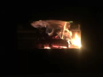

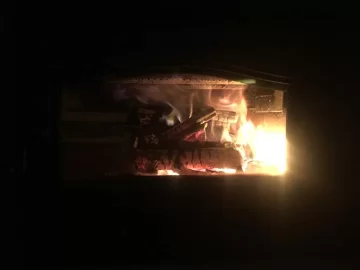

Maybe a pic of your fire going when you have the air shut back down for a all night burn, would be nice.

Not sure if we are talking about the same discoloration. I am talking about the rust color towards the bottom of the front plate where the door seals. Not sure what could have caused those marks that look like drips at the ends of the discoloration. Maybe these are related. Being new to all this I am looking for more experienced help.
Discoloration on the brick in that corner is common. When I shut the air down the left side stops burning but the right side keeps burning. Posted a photo here: https://www.hearth.com/talk/threads/jotul-c550-rockland-questions.124516/ post #10. Sounds like a common issue. Not sure if there is anything I can do about it.

Anyone know how to get the discoloration off?

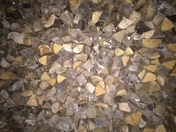

i think your vaulted ceilings are hurting you. Also nobody has mentioned your wood moisture content. seasoned wood will give you double the heat output as unseasoned. When you buy your wood do you split it and check the inside moisture? If you can't get secondaries at 600, then you are boiling the wood, not producing heat with it. Go to the supermarket and get kiln dried wood. See if anything changes. I see a major difference in my insert burning actually seasoned wood. Good luck

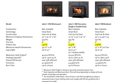

Sounds like you have a Jotul C450 did they sell you the correct stove?
It's definitely the C 550 Rockland (2.08). I have the brochure at home. Have been investigating it the last 3 weeks. Maybe they measured or rated it differently when it first came back in 07-08?
Do you mean this brochure? (broken link removed to http://jotul.com/us/home/_attachment/11056?_download=true&_ts=13d647fa1fe)
I am pretty sure that is a typo and should be 2.8 cu ft as was stated above earlier. The firebox of the Rockland is quite a bit bigger than the one of the Kennebec not just by 0.03 cu ft. That taper also does not cost you almost 1 cu ft.
agree with the moisture comments. had some wood that got rained on a few days before trying to burn. what a waste. sizzled and wouldn't get stove over 400 and no secondaries.
my best fires get secondaries firing up around 425deg. once they light, stove temp gets cranking. one piece of wet would ruins the entire fire.
That's it. Hmm, I just assumed they would double/triple check something like that before printing out hundreds or thousands of brochures. I have not seen the C 450 in person but comparing the Rockland to other 2.3-2.5 cu. ft inserts the firebox seems smaller to me. I'm definitely not expert on sizing though! May have to contact Jotul to verify for sure.

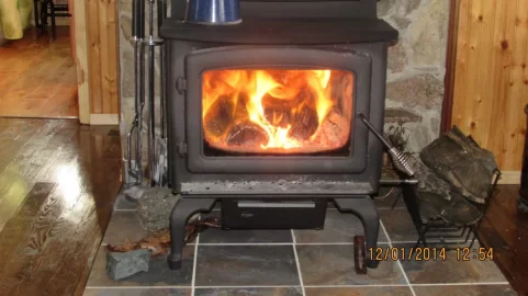

Here are a couple of photos when the stove top hit 700* last PM. These are typical of our fires.

Well now I know where the 2.08 cu/ft came from. I did the numbers and come out with a Edit: 2.0764 useable cu/ft. firebox.

Going to check another split tonight. Pieces I did check where under 20% Ranged from 16-19%. Something I noticed about the wood I bought is it does not have much weight to it. Dry punky (i think is what it is called) looks rotted. Again new to all this. I did call a tree farm that is putting in a kiln they say they are shooting for 20%mc. At this point I am hesitant about buying more wood.

Well now I know where the 2.08 cu/ft came from. I did the numbers and come out with a 2.07 useable cu/ft. firebox.
