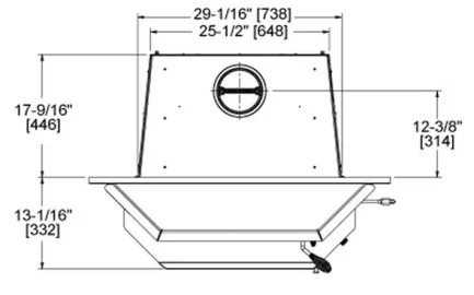

I just looked up the firebox dimensions:
25.25" Wide by 15" Deep by 14" high.
Unfortunately these are not the usable firebox dimensions. In reality you are not going to load much more than 3" above the bricks and not right up against the glass.

Right now it is a toss up between the Hearthstone and Enviro. About the same size firebox. I do not think the summit will fit. My fireplace dimensions are 37" Front, 22" Deep at the bottom and 21" deep at the top, 22 1/2" at the back and 27" Tall.
How wide is the fireplace at 18" deep? If there is 26" it should fit.

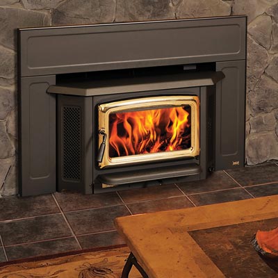

Looking at your pics of your fire burning looks like your not using 25% of that firebox.
Looks like your getting secondary burn.

BE, Only 24" wide at 18" deep according to me doing a layout in CAD.

(broken link removed to http://www.quadrafire.com/Products/5100i-Wood-Insert.aspx?page=Overview)

Thanks for the link will look at that unit also. Edit: To wide at the back with existing opening.

Too use one of the bigger inserts since your hooked to a stainless steel liner you could hire a masonry guy to do some decorative masonry work to fill in any gap behind the decorative surround of the insert. As the surround wouldnt be able to fit flush but it would only be an inch or two to worry about. Just an idea. The surround seal is not as critical since your hooked to the SS liner as in the old days the inserts would just be pushed into the fireplace and the surround would be sealed and the draft of the flue was supposed to draw everything up the chimney so no smoke leakage into the room. Todays liners are much safer setup.
Something to think about. Maybe modify the brick in the fireplace. I would have to wait until Spring/Summer. Hopefully this winter will not be as bad as last. Northeast is missing out of the warmup that is occurring:mad:
If the gap is under 2" it can be filled with a piece of angle metal painted black and attached to the back of the surround.

Went and looked at a Clydesdale and am thinking about that. I know it is not much bigger but it has a deeper firebox and protrudes out some to get some radiant heat. I do know that some of the splits I just c/s/s (8" x 4" x 20") will take up to much space in the Jotul. Figure I can only get 1 row and 2 high with a real small split in front to ignite them.
I think the Summit is the answer with begreens idea. I think it can be done as the stove exhaust connected to the stainless steel liner so no need for the surround to have an air tight seal. Look around for a good metal working shop to fab up a custom spacer and buy matching paint to your surround.

Looked at those pictures. That is what I try. 550 Is long and narrow. Clydes is more square. Need to see if I can find a PE Summit in the showroom. That is a problem in my area everyone sells them but very few that you can go touch.
