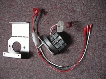

The motors you referenced look nothing like what I need ,my is about 3.5 in diameter and 3 inch in height
  • Need a castile feed motor but don't want to spend $170.00

Could you post the numbers off the motor, please?
